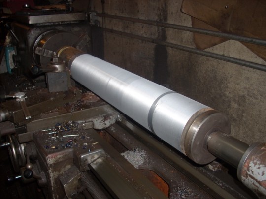

well i paid for a peice of 8x38 1018 hot rolled steel today, and it will be here in a few days.  I am building a full scale mountain howitzer.   i guess we will see how it goes.

WOW, and on a 13x38 lathe!   :o
It can be done, with some ingenuity and good engineering.    ;) ;D

yep, i have to cut the steel down to 37.5 and I am afraid that i might have to take the steel to my buddys lathe to turn it down to 7.5 so i dont rub on the  cross slide. but we will see when i get it here.  I have to load the steel in the lathe with a engine hoist.  it will be a learning experience for me. I will be  sure to post pics.

yes, thanks i got the manual,  I rebuilt my steady rest, and works, ok, but I will not be able to bore the gun myself, I will be sending out to a friend that has a vertical gun drill to bore it. so i wont? be able to use the steady rest the barrel will be too big.  I cant wait to get the steel to the house, and man handle it to the lathe.

I cant wait to get the steel to the house, and man handle it to the lathe (a piece of 8x38 1018 hot rolled steel.)
That's about 525 pounds in case you haven't weighed it.   ;D

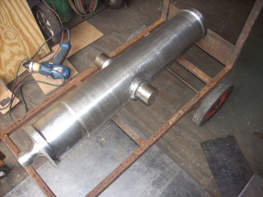

Just a thought, have you considered boring the round first.  I used a bull nose to hold the barrel in place while turning the OD.  I also welded the rear plate and breech knob.

hey dom, i had thought about it or just using a peice of tubing and using a breach plug, but this gun will be for my personal collection, and that is why i have decided to make this peice out of one solid steel round. the only thing that will be welded will be the trunions. before it is bored.    I know being bored first would make it alot lighter. but I dont want to risk warping the bore when welding the trunions on.  I need every advantage i can get when shooting against 24lb field howitzer. at 100 yards.   I want to be able to load this gun up and shoot it up at grayling.

 I keep seeing these "Mountain howitzers" with a reduced diameter at the breech, right where the pressure is greatest. What's up with that? The parrot rifle with a larger diameter at the breech makes more sense to me.

The powder chamber being reduced in size gives adequate thickness of metal.  And the rest of the bore needing less thickness can be much larger in proportion.  The combination gives a very light weight barrel shooting (albeit for shorter distances) a large bullet.

In that era of artillery one of the goals of the military (our's and other nation's - that's a French design) was to have field cannons that would be as light/mobile as possible while still remaining safe, and this is especially true of what is known as mountain artillery. That Howitzer has a reduced powder chamber, so the outer metal around the chamber was removed (to be more specific, that's how it was cast) from the straight profile of the tube for the sole purpose of making it weigh less.

 Reduced diameter chamber, that makes sense, back to bombard technology. It brings up a flaw in my understanding of the reason behind the powder chamber, I assumed part of it was the extra material around the chamber, so instead it's there for some other reason.
