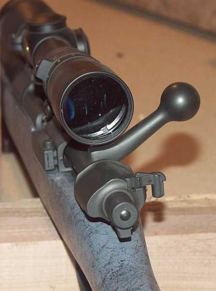

Hmmm well I see lots of negatives posted here and some strange comments and especially about higher mounted scopes  ::). Now although this is a Swedish Mauser, Husqvarna 46, it has the Mauser safety and it's related issuse with scope use:-
Yes it has high scope mounts fitted. Now can you really say it's not a classic?
The scope is a Bushnell Scopechief 3x. Now I had to modify the blot handle slightly like this:-
I carefully ground a scallop out of the top of the bolt handle in a 6" off hand bench grinder and then cold blued it after polishing with 600 wet and dry paper. The flag saefty does not clear the scope bell but as yet I have not done anything about it. In the drawer is a Mk11 low safety for a Mauser 96 but first I want to acquire another bolt shroud before messing with the one on the rifle.

I had one replaced on the Swede:-
The safety needs to be altered/converted at some point. The original had just been forged down and was not really suitable.

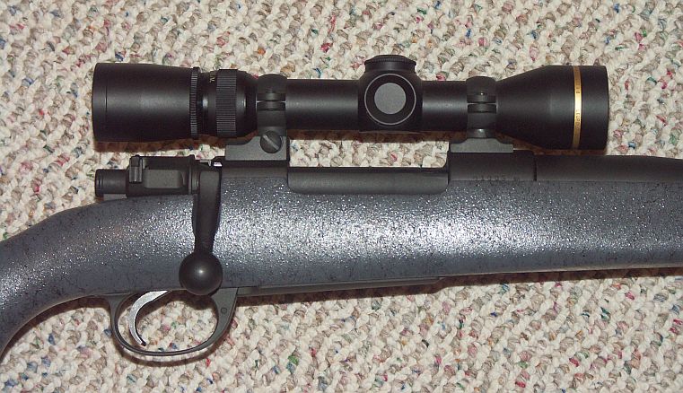

Offline IOWA DON
  • Posts: 514
Re: Mauser 98 safety and scope mounts?
« Reply #16 on: February 04, 2011, 05:01:30 AM »
I think you would like a very low mounted scope better. Here's my 1909 Argentine 7x57. Not much wiggle room for the scope or anything. (Leupold base and rings, and a 1.75-6X VXII short tube scope.
