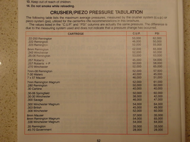

I have been noticing in manuals that some loads are measured in CUP and some in PSI. The CUP is usually about 10,000 less then the psi. I'm wondering is there a formula to calculate cup to psi or vice versa? Also how does CUP and PSI comepare to each other is as in 40,000 cup to 40,000 psi?

I don't think there is a reliable one. If you check out some older manuals when cup was the only test used and compare the new editions when the manual was updated using psi mesurements you will often notice a reduction in max load data. for safety reasons. Some loads exceeded safety levels but the cup mesurements did not reflect it.

This topic gets brought up and asked about from time to time. if you do a search, you should find a few threads on it, but.. CUP and PSI are very different ways to measure chamber pressures and there is no cross over formula. i have looked, and i have tried to use algebra to make one without success.
some reloading manuals have explanations of how PSI and CUP are derived and Wikipedia has them too, and you can see that even though they both run out 40,000 CUP and PSI, they vary in their incremental spacing and do not correlate to each other.

PSI is pretty linear, CUP/LUP is not, can't make a math comparision between a constant and a variable.

There is no way to compair the two.
Some are close to what you say while others are way off.
There are a few rounds where PSI runs less than the CUP.
Just can't be done.

That's probably Denton Bramwell, see the Shooting Software .pdf file I posted.... Correlating PSI and CUP
It's also discussed in this article. http://kwk.us/pressures.html
http://www.shootingsoftware.com/ftp/psicuparticle2.pdf
Conclusions
1. PSI (correct use) is highly correlated to CUP. Evidence: R^2 = .927 makes it
impossible to successfully argue otherwise.
2. CUP is mainly an indicator of peak chamber pressure: Evidence: The way that
piezoelectric systems are commonly used, they report purely peak chamber pressure.
The CUP system is highly correlated with the piezoelectric system. If the “off-peak”
deformation of the copper pellet were large, the correlation to the piezoelectric
system would be poor.
3. SAAMI did a pretty consistent job of setting maximum pressure limits in both
systems. Evidence: The two are highly correlated. Basically, they got pretty close to
the same answer both ways.
4. You can convert from one system of measurement to the other. Evidence:
Definition of "correlated". Basically, correlated means that you can estimate one
variable from the other. The opposite of this is "statistically independent", which
means that you can't.
5. The formula for the conversion is the one shown above. Evidence: Produces the
"least squares fit" for the two systems, and it produces an R2 of .927. You can test the
formula by plugging in any of the CUP numbers shown above. The formula will give
you back a PSI number that is close to the one shown in the table.
6. Work remains to be done in refining the SAAMI conversion. Evidence: An R2 of
92.7% is produced, leaving 7.3% of the variation to be explained. Measurement
system error probably sets the limit of the R2 that can be obtained at around 98%.
That leaves 5.3% of the variation unexplained. Perhaps someone can discover what
the unaccounted for variable is.
7. The first example of something disproves all claims that it does not exist. The
formula exists, and it works. So all claims that it does not exist cannot be true.
