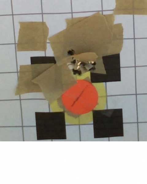

I would say you have a fifty-fifty chance.  In the early 1970’s there was a guy on the job who bought two or three tang safety Ruger rifles.  He could not get them to shoot and he was not a reloader.  A couple guys were waiting in the wings because they knew he would sell them at a lost.  Once the guys had the rifles in hand between bedding and reloading they have good accurate rifles.
I decided I needed a magnum and the owner of a local shop had a deal on tang M77 rifles.  As I posted before the new rifle shot patterns not groups.  It has shoot pattern consistently for thirty years until I tried 160-grain PMC ammunition.  I was shooting it up for the brass.  This is the best factory ammunition group I have from my 7MM Remington Magnum.
If I recall correctly this is a six shot group.
There has been a lot of discussion over the years regarding the difference barrel sources Ruger used for the early M77.
I also replaced the hard rubber butt plate with a Pachmayr Decelerator what made a world of difference.
Knowing what I know I would buy if I wanted another rifle and the price was right; knowing that I might have to do some work to make the rifle a shot.
