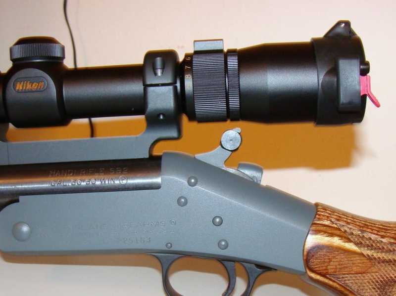

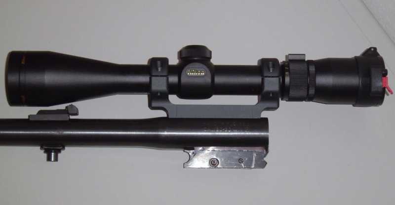

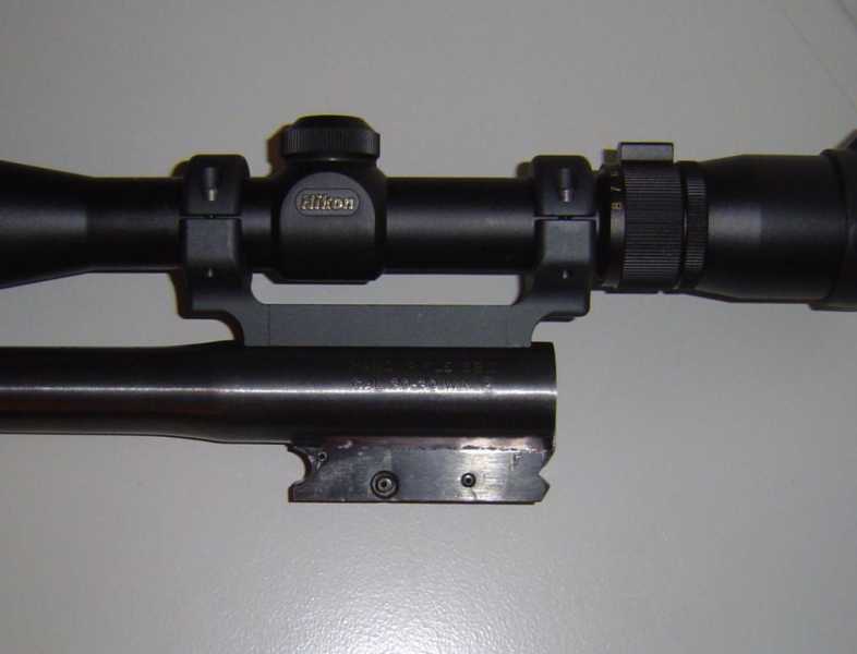

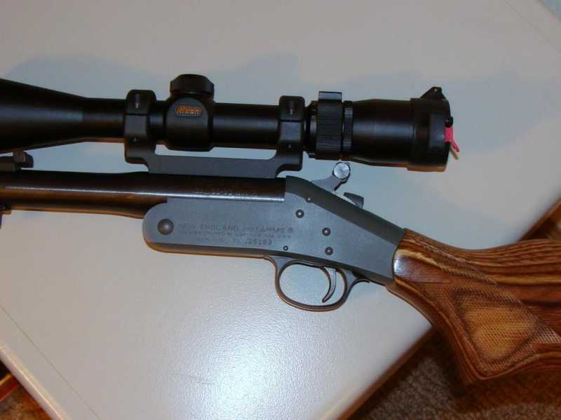

  It's a bit difficult to measure the height while it's assembled. My mount is the High mount, so the average height should be around .719". Good thing is...it's clears my front sight. ;D Here are the pics:
Thanks, Dinny

Hey Dinny, Thank you for taking the time to take the pictures for us!

Thanks Dinny!
 It does look good. Nice and clean. Do you think its any lighter? I realize it would be a minuscule weight savings if any. But what to  you think?
I hate to impose any further, but do you have any closeups showing hammer clearance?  ::)

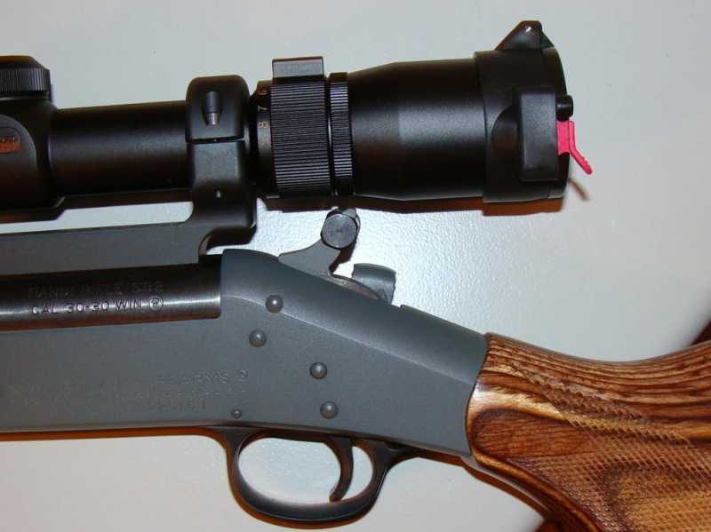

CW
CW,
  I can't tell of a weight difference. Lemme see what I can do for hammer clearance, the 30-30's receiver is getting coated this week. I forgot the barrel at home or it would be gone too. BRB

Hammer clearance pics:
Thanks, Dinny

« Reply #19 on: November 28, 2010, 05:34:38 PM »
THANKS AGAIN DINNY!!!
 Top pic tells me exactly what I needed to know!!!
