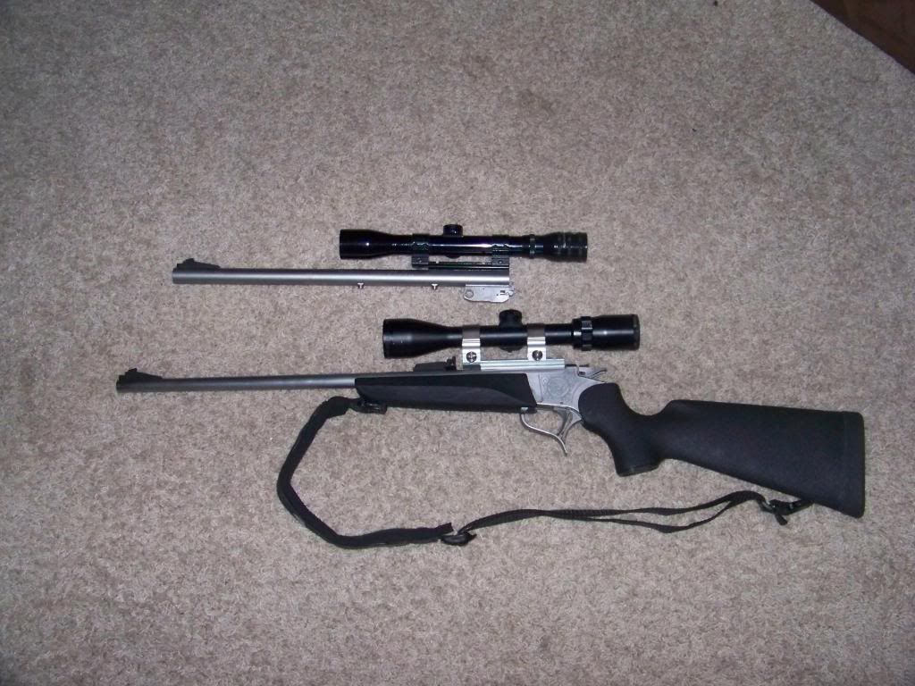

Well, after shooting an Encore 209x50 for several years, I finally purchased a Contender.  I had found an original SS Contender Carbine that a guy wanted to get rid of pretty cheap, so I took the plunge.  I don't think he was too familiar with it since he told me he had never seen one engraved on the side and thought it was custom.  Anyway, I finally went to pick it up.
Seller told me the 21" barrel was a 30-30 and the 16" barrel was a 22 Long.  I went to pick it up this evening and was surprised when he pulled out some 22 ammo to go with it and it was 22WMR!  I took a look and found that the 16" barrel was indeed a 22WMR from the Custom Shop!  Not exactly sure what makes it different, but it does have a nice target crown.
For the price I paid, I'm extremely satisfied.  The 30-30 barrel has a great bore with a few handling marks on the exterior.  The 22mag barrel looks fantastic!  The only problem I have is that the 22mag barrel is a bull and won't fit the standard forend.  Guess I'm going to have to make another investment...   ;D

     The only difference between your Custom Shop barrel and a factory S-16 22WMR(which, BTW, is no longer made)is the contour....yours is a bull and the S-16 had the same contour as your 21" 30-30.  If you want to use the same forend for both you can relieve a small amount of material from the front half of the barrel channel and then use a spacer around the front forend screw boss when using the 30-30 barrel.  A lot of us do this anyway just to free float the forend. ;D

Excellent information!  I was wondering what made it "custom".  I'm actually going to pick up a G2 forend and open up my options of barrels for this set-up.
I managed to shoot it a bit and was really impressed with the rifle.  She's extremely light and easy to handle, but the recoil on the 30-30 was nothing.  There's a bit of muzzle jump with the shorter barrel, but the accuracy was great.
I put on the 22mag barrel with no forend just to get a few rounds off and it was a hoot!  It's pretty loud with that short barrel, but there's no recoil and accuracy was excellent.
