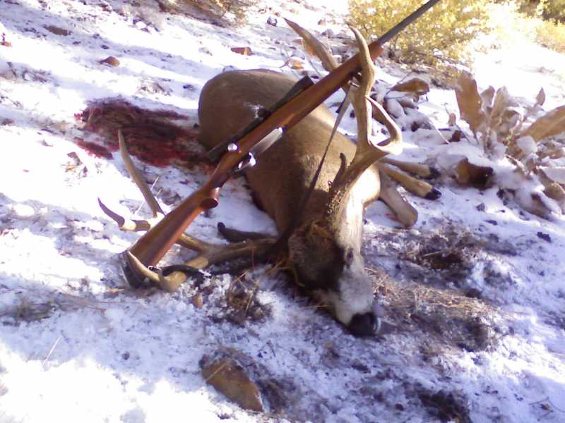

Many a day I or my hunting partners will leave a rig at the top and another at the bottom of the mountain.  We normally hunt National Forest lands.  At the end of the day after making this hunt start at 6700 foot elevation and dropping down to 3500 foot we stopped by the hospital so our hunting partner could get his leg x-rayed after a hard fall.  Ice on rocks make for slippery going, hard on the body and equipment.  His Husky along with his Leopold scope, in Leopold mounts suffered no damage.
I am too old for this hunt now, it makes for a long day and if a buck or so is taken it comes out on a packframe.  I have proven a number of times on this hunt that a 270 Winchester is very effective on rattlesnakes.  This country offers shot from the end of the muzzle out a few hundred yards.  The brush is forever tearing at the hunters clothing, and gear.
In the early years I like wearing a little pair of deer skin gloves to grab brush to let down step spots or protect me if I had to grab poison oak to steady myself.  I have a scar on my 760 barrel from a trip down this slope.
When it comes to deer hunting there are a lot of temperature extremes.  In Colorado I have gone from 85˚ to -20˚in 24 hours.  In California I have gone from the 90’s to 15˚ on a hunt.  When I was a kid I would shed the gloves when the temperature warmed up during the day.  If I left them on the bluing on my rifle would be in better condition.
The point is that the Weaver steel (El Paso) base and rings held up very good on my rifle.  I received this rifle on my 14th birthday, and it was my only deer rifle for thirteen years.  The first year I hunted with the factory sights and the second year I had a Williams peep sight on it.  This is an early M760 and it was not tapped for a scope.  I paid a gunsmith to tap the receiver and mount the scope.  This is the rifles 53rd year.
I have had three or four different scopes on the rifle.  When I installed a Burris FFII with BDC on the rifle it required medium mounts.  The original base is there.
This rifle has taken some interesting rides, one of the more interesting was when I was sliding down a steep slope beyond the point of repose and a large lizard ran up my pants leg just short of the crotch.  At the time I did not know what it was, I grabbed its head thru my jeans, while hopping around trying to maintain my footing and not lose control of my rifle.
As I squeezed its head I could feel the claws on the feet digging into me.  The feet were a clue that it was not a rattlesnake.  I had to lay the rifle in the dirt so I could pull my jeans down and get to the critter.
The rifle and scope survived the event.

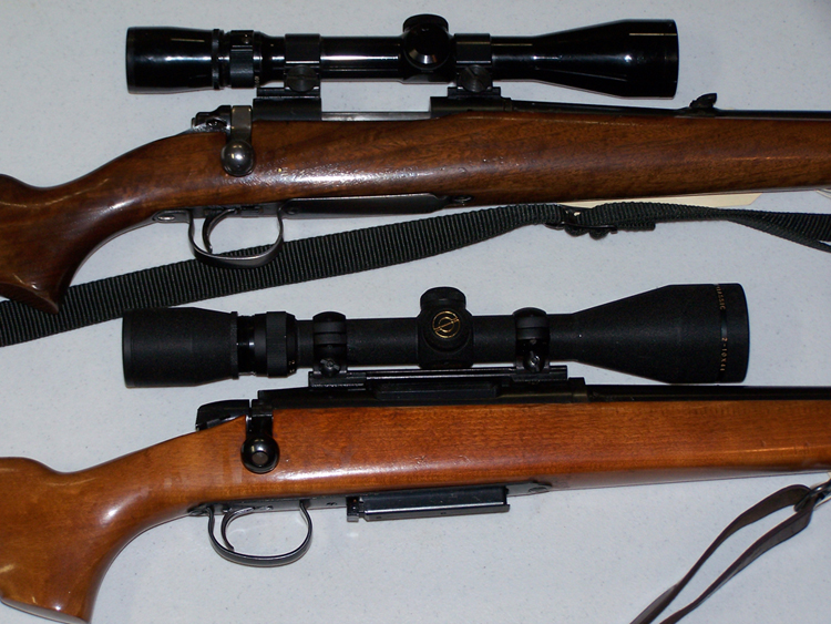

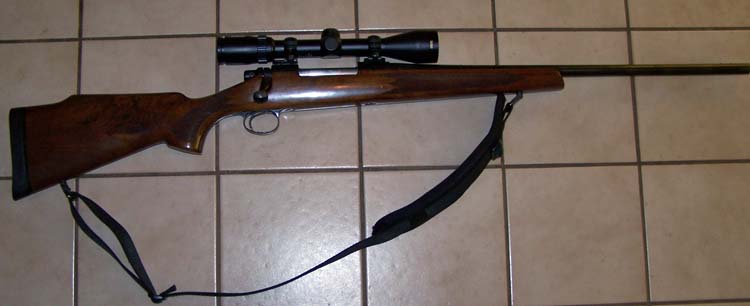

I like my scopes as close as possible to the bore without contacting the barrel.  Three examples:
The installation of the Bushnell Elite 3200 3x9-40 in what I call a low medium mount gave the rifle a whole new feel.   Most of my deer shooting is at close range with the animal moving or about ready to kick it into gear.  This is similar to law enforcement combat courses with a shotgun.  My duty 870 had a Williams peep sight on it, fast and effective.
Before the Elite the 700 had a 2x10-44 Simmons Scope on it.  The scope required high rings.  I believe the high rings put me at a disadvantage.  I collected a couple of bucks using the high scope, one at long distance from a setting position.  I did not feel a handicap the first time, but I did when I shot this deer.

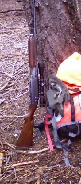

I was setting at the end of a large diameter log in the woods.  I had slowly rotated to my right when the buck came in to my view.  He was feeding on a wild cherry bush.  He alerted to my movement and I was trying to get the rifle into position to get off the shot.  At the time my mind was telling me that getting the crosshairs on him was not very slick.  The shot went behind the shoulder and did the job.  It was the first time I have seen the hide on a deer ripple like pond water when a rock is tossed on it.
I rather doubt if I will buy another scope over 40MM again.  I prefer 38MM to 40MM on a 9 or ten power scope.
A clear transfer of knowledge/skill happen when I went from using a M760 starting at 14 years to carrying a Remington 870 shotgun in the law enforcement field.  Of course the payback was in both directions.  My skill level improved with all those rifle slugs the taxpayers issued me.
Another view of the M760 better highlighting the low mounting of the scope.
I have been impressed with the Burris FFII 3X9-40MM scope.  This scope is mounted slightly higher than the scope it replaced.  Knowing what I do now I might have bought the Burris 2X7-35 scope for this application to get a lower mounting.
You can tell from this picture the hammer on the Marlin 336 just clears the scope.  This Burris 2x7-35MM sets a little higher than the 4x El Paso Weaver it replaced.  The Burris has a larger eye box then the old Weaver.     I had been hunting timber stands and a large pine plantation where they had cleared long strips for new planting.  I felt the 4x scope limited the opportunities that I was willing to take.  The Burris is a better glass then the 50+ year old Weaver.  After watching some deer from 160-yards to 200 yards I carried the M760 the next day.

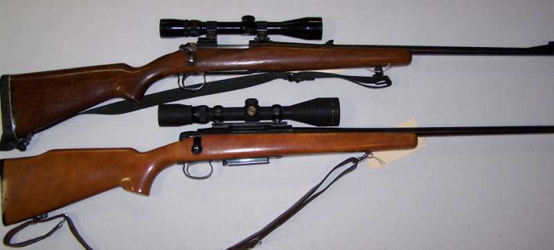

First I must eat a little crow.  In an earlier post I stated that:
Here is a good example of a 44MM objective  mounted on a rifle using a medium height rings.  The design of the receiver and the base mount in this case allows the scope to clear the barrel and provides a low mount.  Bottom scope is a 2x10-44MM.
Here is another bird on the plate, crow is a little chewy.
If I was taller and had a very long neck I might like taller mounts
This top rifle was my Dad’s deer rifle.  I made three changes to it, installed a recoil pad, replaced the scope, and handloaded the ammunition.
I was looking at this old 722 the other day after reading Charles p post and was thinking I need to buy another pair of the medium or low mounts for the scope.  But after handling the rifle and memory kicking into gear I remember why it has high mounts.  If you look at the picture the rifle has the old style stock designed around low iron sights.  The stock has a very low comb.  In this case the scope comes up before my eye.  I recall with a different scope the rifle had low mounts on it.  The rifle has large front sights that use to show up in the scope, frankly it bugged me.  That is not an issue now.  Dad had removed the front sight from the ramp, but I put it back in along with a folding Lyman rear sight.  I like have the iron sights as backup.
For  the hundredth time I must post the picture of the mule deer I killed on the run with Dad’s rifle.    It is hard to beat success.

Compare the drop in two of my rifles the M760 and the M700.  The M760 by serial number was manufactured in 1954 and must have set in a warehouse unit it was retailed by Monkey Wards in 1957.  If you look at the picture of the rifle you will see the stock has a lot of drop, it was designed for iron sights.  In fact the stock had enough drop to be a duck gun. (Picture in earlier post.)

The scope on the Remington 788 is the Simmons 2X10-44 that is part of the scope switching test.
I compared the latest Trophy with the Elite 3200 and the 3200 looked like a better scope.  I did this at a shop the has a stock that different scopes can be inserted.  The 3200 cost a little more but after taking it the to range I am convinced I took the right step.
