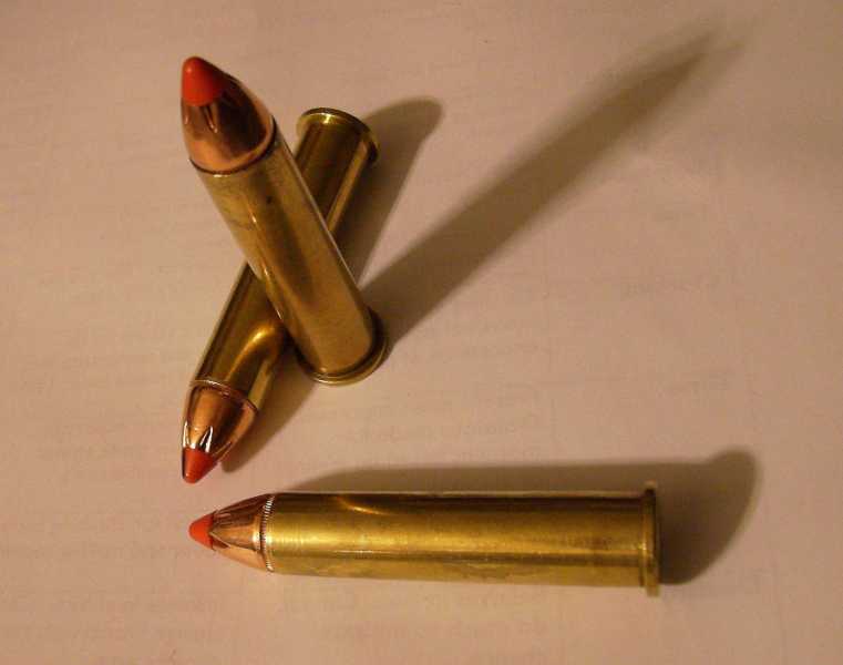

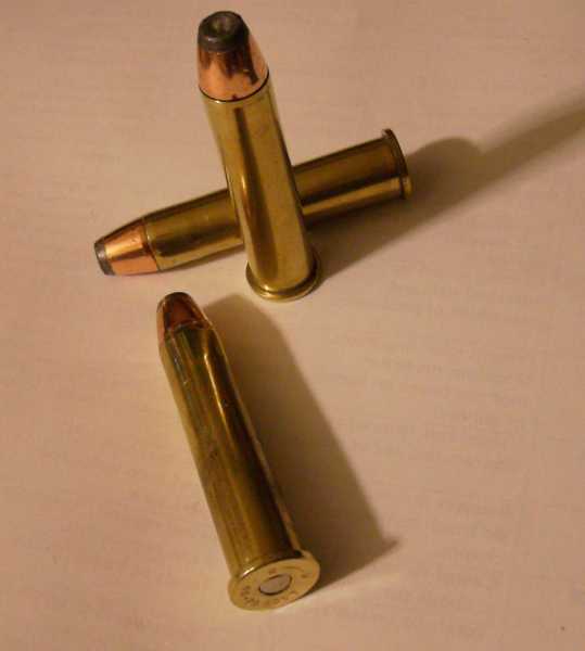

I have the same gun and the same throat issue.  If you read up in the FAQ's there's some information on throating them.  You can rent a reamer from 4D or others and extend the depth slightly, depending on what you are trying to accomplish.  I never used Berry's bullets, but have loaded several other configurations with success.  I load the 325gr. FTX with no issue and good accuracy and have gotten nearly identical results with Hornady's 300gr. HP jacketed bullets.  I have had issues with other 350gr.+ bullets, but the hp took it's first deer this year.  ;)  I've heard good things about the Remington 405's by others here too.

Mike are you using a good solid crimp?  I use a Lee Factory Crimp Die and make sure it's firm enough that the bullets cannot spin, but not tight enough to deform the bullets.  I was having a little issue with variability until I started really being careful to seat to the same depth about 2-4 thousandths off the rifling and good crimps.  Was getting about 2-3" groups at 100 yards with the FTX loads (first I tried with the .45-70) and after starting to use the FCD it dropped down to just above or below an inch.  I think the straight walled (or nearly straight in this case) rounds really necessitate a good crimp.  I have had the same findings in .45 colt.  The only unique loads I've made are round ball loads, which will do 2-3" at 100 if it isn't too windy.  Other than that I'd recommend trying out Reloader7 for the .45-70 as I have found it an excellent powder in loads from 34gr (trapdoor level) to 46.7gr (my goto do all load) to 52gr (Whoppin' load) levels.  Good clean burning too as I rarely do more than run a bore mop down it to get it shiny again when shooting.  ;)  I do find that I get my best groups with 5+ minutes between shots though also.  I keep the forearm down a bit although I haven't modified my factory BC stocks yet.  ;)  Good luck.

I have seen that from Tacklebury before elsewhere, and there must be something to it, because I also have a "747" load that is my best jacketed bullet load, 300 gr hp, and 47 gr of RL7.
