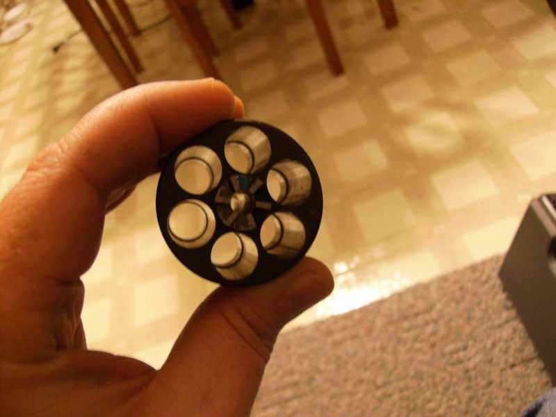

Offline tacklebury
  • Posts: 3633
  • Central Michigan
Re: 45 acp -- 200 grain RN Trail Boss
« Reply #8 on: October 22, 2010, 06:32:54 PM »
Here's a close-up of the cylinder too. ;)
The .45 colt, although it does have somewhat of a rim actually uses the case mouth to partially headspace also.  8)
