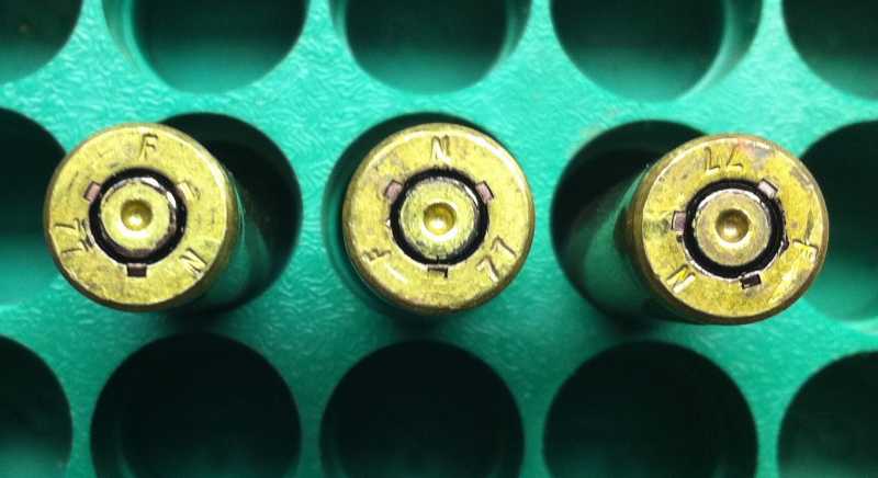

Mis-tree solved  ??? , I got some of the case's from shooter today , their Berdan primed , and talk about a thick base metal , no wonder he broke so many pins , these things are running an ave, of 10g heavier than any of the other 223 case's that I have , all in the base of the case .  :o :o :o
However I have another hair-brained idea I want to try on these before calling them junk though .  ;)

I dunno about the mystery being solved, cause unless I'm blind those cases have a single flash hole in the center of the case head, which makes them Boxer, right?.  I managed to get about 10 of the stubborn things deprimed, and I don't think it is possible for me to push a nice, clean hole through the base of a Berdan primed case with a decapping rod...   I wish I'd have taken some pictures of the ones I did deprime so you could see, but they are mixed in there with the others somewhere.
