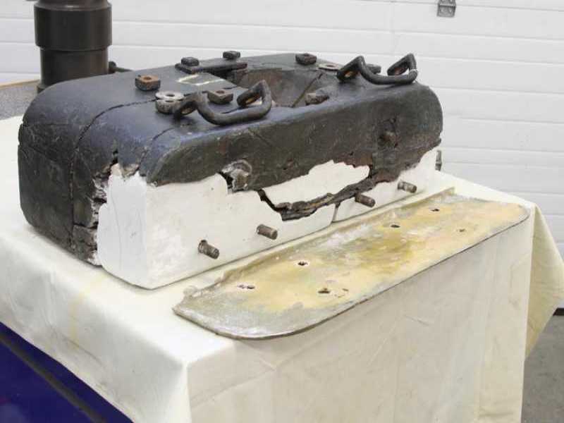

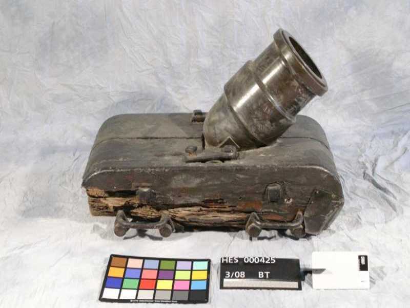

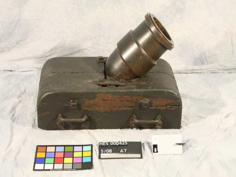

Keep in mind that the mortar bed on the right (with the rounded shoulders) in the period photo may be a unique design, because (as far as I know) there's no other record of that type being used, while the two other bed designs seen in the picture are well documented.
I forgot about this coehorn and bed (that makes two of this type bed that I know of); that's an original bed that was undergoing conservation work when these photos were taken.
