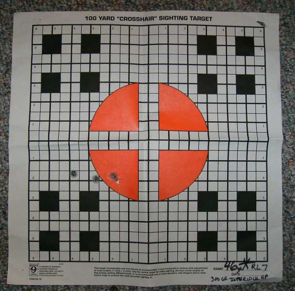

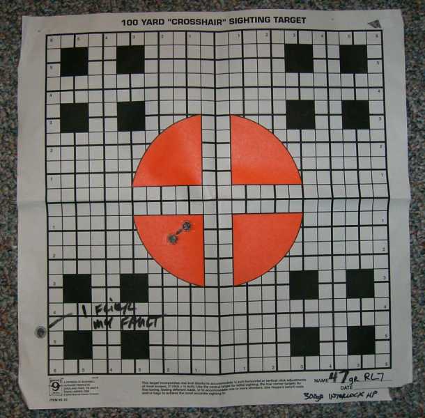

« Reply #7 on: September 24, 2010, 03:18:33 PM »
I haven't landed on a lead bullet mine likes yet.  I'm getting .75 to 1.25" groups from Hornady Interlocks or FTX with 46.7gr. Reloader7.  8)  I forgot my camera the day I shot the intermediate ladder of 1/10th gr. increments from 46 to 47, so I don't have those pics, but the 1gr. ladders looked like this with sweetspots at 46, 47 and 50gr.:
*edit*
The fliers were called and it was a pretty stiff wind that day also from my right side.  These were shot at 100 yards with the std. Williams WGRS sights that came on my BC.  8)
