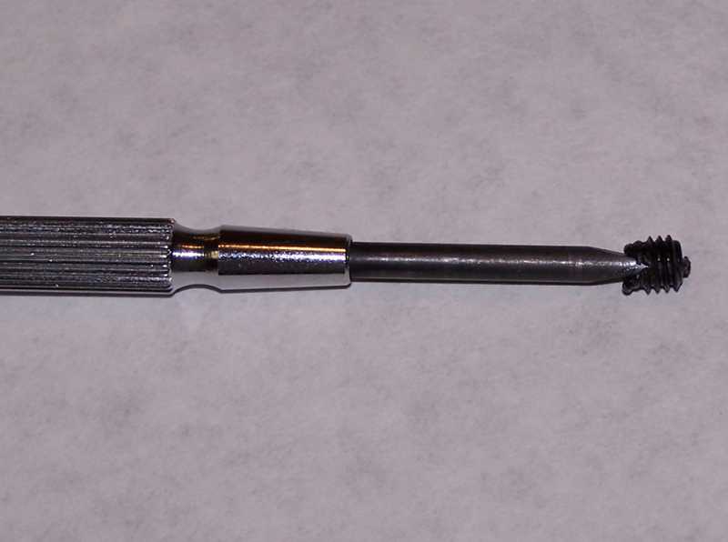

Repair Bushnell Banner BDC Scope with broken BDC retaining screw.
The screw is hard rubber.  Find a screw driver that will fit down on broke screw with clearance for turning.  Remove the screw driver and heat the blade of the screwdriver.  Hold blade against broke screw and allow to cool in place.   The screw is hard rubber and the heated blade will sink into the screw shaft.   After cooling turn the screw out.

Following the directions given by Bushnell Customer Service I heated a screw driver blade of the right size to the point the blade started to turn red.  As soon as I spotted the discoloration I remove the screw driver from the heat.
I had my rifle with the scope setting in a rest.  I centered the heated screw driver on the top of the screw.  It took a second for the blade to heat the top of the screw and then I had to stop it from over penetrating the screw.  I held it in place a minute or two and then stepped away for about five minutes letting it cool.
When I applied turning pressure to the screw driver I could feel resistance and I heard the first click as the elevation changed one click.  There is a shallow grove across the top of the adjuster in which a coin can be used to turn it when the hole for the screw is not occupied.  I tried with little success of holding the adjuster in the lip of the shallow groove with a second screw driver.
The adjuster clicked a second time and I felt the screw give slightly.  On the fourth click the screw came out.  I gained one inch of elevation in the process.  I adjusted it back four clicks.
