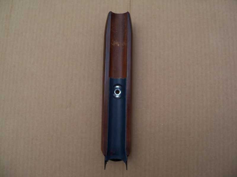

Hello everyone,
  I have been contemplating having my synthetic forends glass and pillar bedded. I have been told that there isn't an epoxy-type bedding compound that will reliably stick to the synthetic forends. My source of info is very reliable and competent, he has tried almost every type of conventional bedding compound there is and has roughed-up the surfaces and even tried treating the surface with a hardener. Once the forend heats up, things start pulling apart.
Anyone had any luck doing this themselves? Any suggestions?
This is what I want to have done.
Thanks, Dinny
