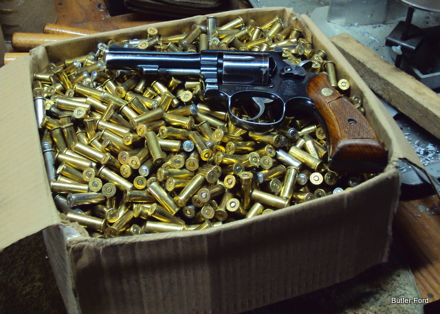

Trying to give new meaning to "Grab a box of bullets and head to the range".
Was asking about a wadcutter mold this spring and was told the the Lee is as good as any and better than a lot.  I got a Lee 6 hole non tumble lube.  The alloy is 8lb wheel weight, 8lb plumbers lead and a half pound of tin.  I got a few thousand cast, sized .358 and lubed in the bottom groove only with White Lable BAC.  Then I was sidetracked by summer farm work.  Finally got all the brass I hadn't loaded with 358429's filled with my new wad cutters.  Midrange load of Bullseye shoots quite well out of the S&W 10 and 15.  I haven't tried them anywhere else yet.  Now I get to do the important part....Practice, practice, practice.   ;D

Looks like fun!  I'll bring the cold beer!

have to laugh thinking back a couple years when i went to my buddys house and he had 4  5 gallon plastic pails filled with loaded 38s

You shoud pick up a .357 Handi Rifle to go with that box.

I have one.
Lloyd, I cannot imagine sizing/lubing enough bullets to load 20 gallons.  I hope he was using something other than an old leaky Lyman.
