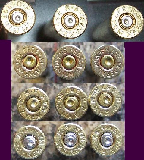

« Reply #11 on: July 13, 2010, 02:17:49 PM »
The top three in the picture are mine using the CCI 450 primers.
The other nine are pictures of one of the other members here who was having trouble with his primers cratering with different types & brands of primers. I can't remember which frame he was using. The bottom three I believe were CCI 450 primers.
Bill
Re: 357 Max - SB1 - What Primer?
« Reply #12 on: July 13, 2010, 03:40:35 PM »
Excess headspace plays a roll in cratering I believe,  and 357Mags seem to have plenty of headspace with their deep rim cuts, at least all that I've worked on have including both of mine. If you can shim the extractor out to hold the round against the standing breech, I think those craters will cease to happen.
