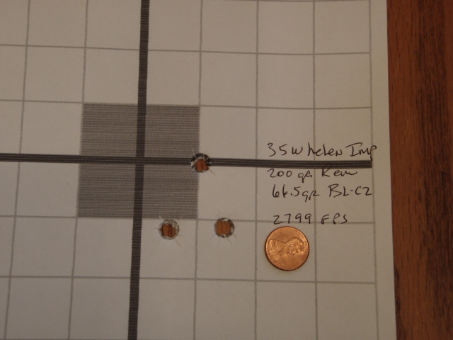

Made another range trip today, I'm getting real tired of primer problems, used CCI 200 and 250 in all the loads today including some for my son to shoot in his Winchester model 670 30-06, he and I both had numerous misfires with the CCI 200s, most of mine went off in all three of mine, but not all of them did, and the CCI 250s that I test fired before loading them in the 260 were even worse, I gave up on the Berger loads which had the 250s with IMR4320, only 1 in 7 or 8 would fire and none on the first hammer fall, and that's after testing 5 of them that all fired at home before priming the cases with them!  ::) Fortunately I also had two other batches loaded up with 120gr Sierras w/RL17 and CCI200, as well as 120gr Nosler BTs w/IMR4320 and CCI200, I had a several not fire, but worked on the second hammer fall, pin protrusion is .063" now, I think I'll increase it to .065" and test a bunch to see if that works, I have 800 of them left, hate to dump em.  :-\
Now for the good news, all shooting done at 100yds btw.... I found great loads for all three rifles including excellent velocity with IMR4320 in the 20" 260 Rem Superligh and accuracy is there too!! The top load I made averaged 2921fps with the first two rounds overlapping and the third out an inch after the 2nd hammer fall, it may have been me loosing focus due to the misfire, or it could have been barrel heat, I was running later than I wanted and was shooting each rifle in quick turn to get thru the loads I had for them, I still didn't finish the 35Whelen loads, but that's for next time.
I finally got to shoot the Super 35 Rem loads(not for use in 35 Rem leverguns) that I made up last year using the 180gr SSP and IMR4198, all loads shot acceptably with a couple that stood out, the start load of 33.5gr ran 2176fps and shot real good with the first 2 touching and the 3rd out a little, but still under an inch. The top load of 38gr was a bit bigger, but still great and averaged 2458fps. It was real strange that none of the 35 Rem loads misfired, same CCI200 batch of primers, they were loaded about a year ago, same time as the loads that failed to fire in my sons 30-06 with Accubonds. ???
I loaded up some 200gr Remington PSPs for the 35 Whelen Improved with BL-C2, start load was 3363gr, it did ok, but 64grs did much better, velocity averaged 2683fps for that load, 66.5gr averaged 2799fps with a nice ~1" 3-shot group, primers are looking good, still have 67 and 67.5gr loads to shoot, but ran out of time. My huntin partner and I decided we're gonna put in for cow elk tags this year, if we get drawn, this will be my elk load.  ;)
