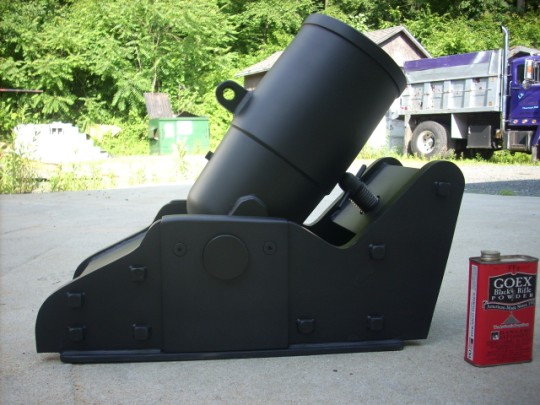

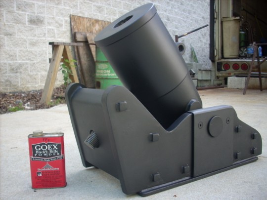

Re: Sled for BB Mortar
« Reply #2 on: May 10, 2010, 03:49:06 PM »
Joe,  Here's a mortar I built a few years back.  It has a steel base, but can be duplicated in wood.  Dom

Since your barrel is smooth sided,  How about a Confederate style base like Lance's.
« Reply #5 on: May 10, 2010, 04:28:10 PM »
Hears a confederate coehorn.
