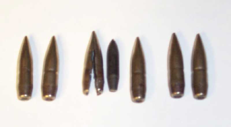

I loaded 46.5 gr. of H4895 behind the 150 gr Hard Ball, and 46.5 gr of H4895 behind the 165 gr AP bullets. Both with a COL of 3.325". Do these loads sound OK? Here is a pick of the AP bullets, the cut jacket and core is in the middle.  Boomer

« Reply #8 on: March 17, 2010, 03:35:07 PM »
Looks like tungston cored. If I were you I'd keep em for SHTF.
