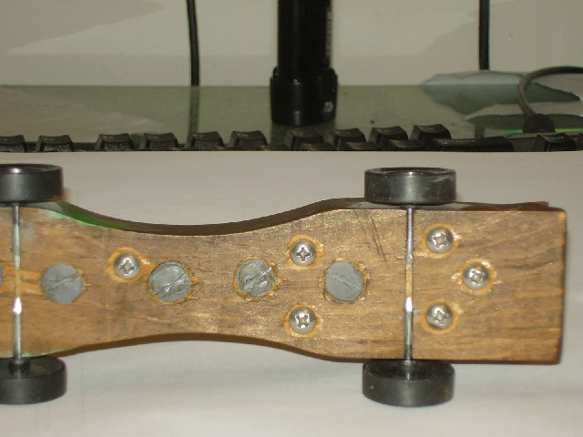

Drill and tap a 2x4 pine board to 1/2 inch. Do this in different depths and pour in some melted lead. After you make a few different lengths. and weights, cut a slot in them with a hack saw and screw them out.
On the  bottom front of the car, (you want the weight forward), drill and tap some 1/2 in holes and screw the weights in you made. Take the weight to the limit allowed. They are easy to screw out and cut off to adjust your weight.

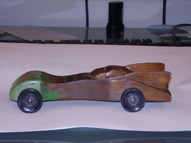

This is a car I made about 20 years ago. It only lost 1 race. I was the first to run and it bottomed on the right side of the track, they would not allow a rerun. Everyone on the right side lost until it was fixed.

This is view of the threaded weights along with some screws for fine tune.
