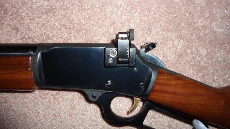

I finally got my 1894 together.
Close-up of the Williams 5D Peep sight.
Paired with my Winchester Model 67 .22 Scout
I originally thought of the 1894 as Short Range Scout Rifle (SRSR) because of its caliber and lack of telescopic sight, but I have decided to call it "Iron Scout" to celebrate its rugged simplicity.
Share my joy and be inspired. :)
Doug
PS More pics of .22 Scout in Rimfire Rifles.

It looks good, but why the slip-on recoil pad?  What scope and base did you use on the .22, I really like it?

The recoil pad is because I tend to be recoil sensitive. I guess it sounds a little wimpy; I just enjoy shooting it more with the pad.
The scope is an old Thompson Center my dad had and the same for the mount. I don't know where he got the mount and, since he passed in '86, I can't ask him.
I thought the mount was a B Square, but I can't find it in their catalog. It mounts to the rear sight dovetail with a screw into a threaded nut that is like an inverted T.
There are more pictures of it in Rimfire Rifles.
You are the 2nd. to ask about that mount; I also posted these pictures on another forum. If anybody nails it down, I'll spread the word to everyone.
Doug

that looks real nice! i like the williams sights!
