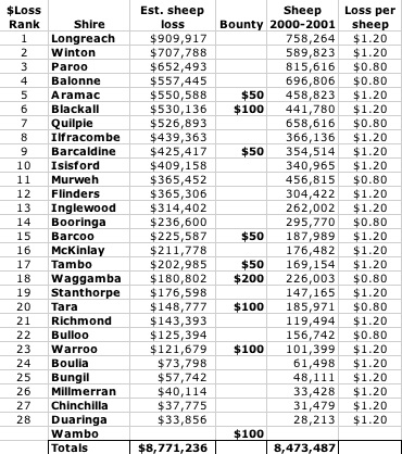

Many Queensland counties have good bounties - $25 - $200 for dingoes and wild dogs. You just have to have permission to hunt and the land owner must sign an affidavit to the fact that you got the varmints on their land. The hunter then has to take a strip from nose to end of tail and turn it into the county (shire) person in charge of pest management. You have to have an Australian tax #, and they will cut a check on the spot. If someone had some smarts, they would set up hunts in counties with high bounties for US shooters, and the bounty would help offset the cost of the hunt...that is one of the ideas I have for retirement. ;)
The last time I surveyed the counties the bounties were such:
