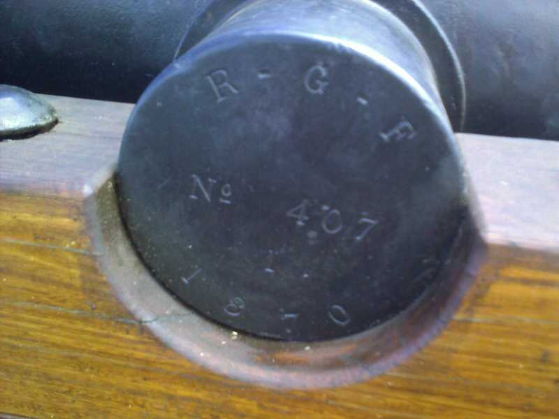

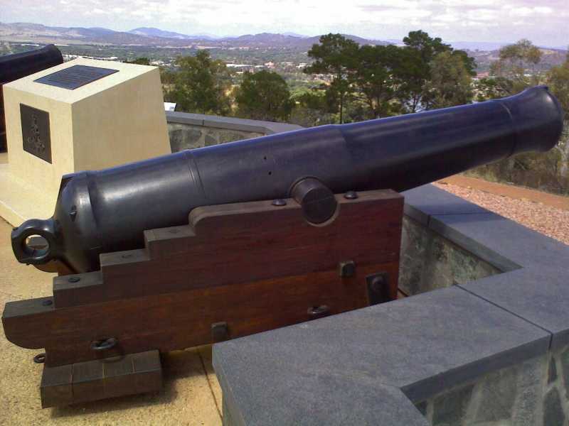

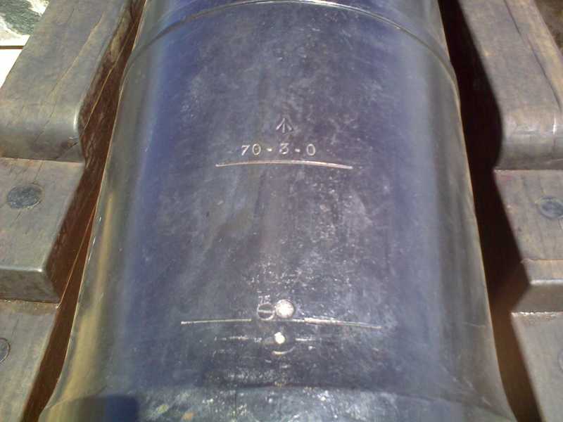

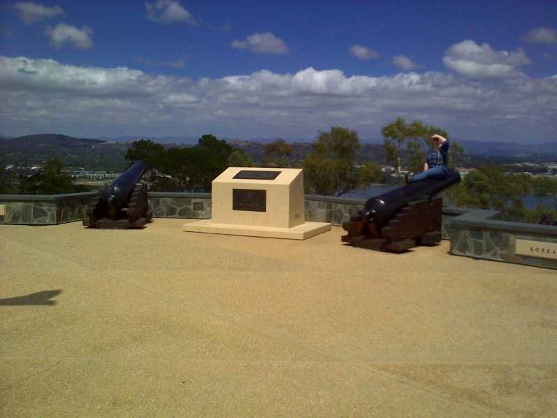

would like a little more info on the markings please .... and can you guess where they are :)

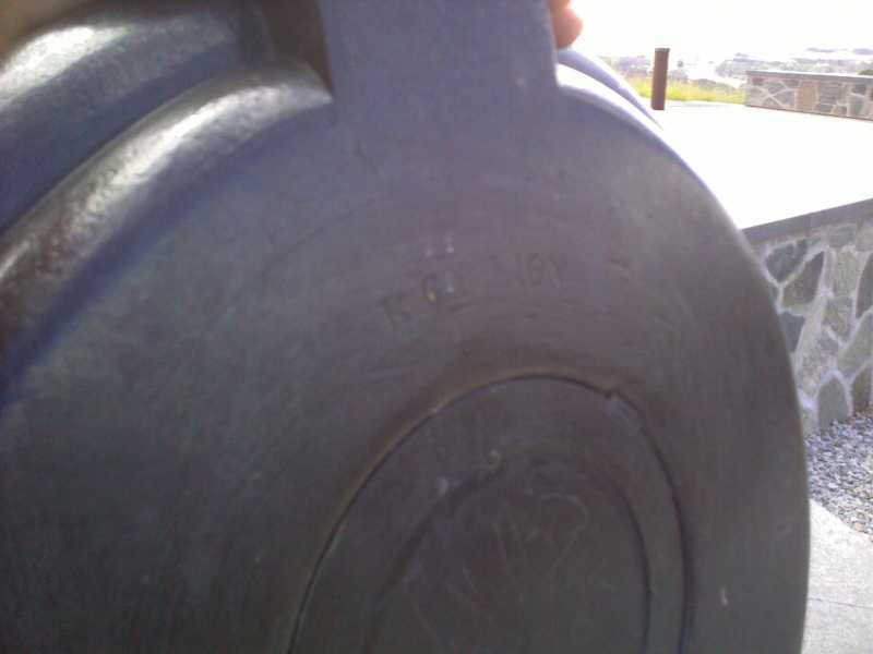

had to use a phone camera so pics are not so good ... will go back with a better camera and try to find out what the marking on the frount is, the number on the other cannon is 398

Australia? New Zealand?
British Rifled 24 pndr  RFG = Royal Gun Foundry. serial # 407 manufactured 1870
70 -3-0  Weight broad arrow = government property mark.

Memorial to the Royal Regiment of Australian Artillery on Mount Pleasant, overlooking Canberra.
Rifled Muzzle-loading 64-pounder 71 cwt (hundredweight) gun converted from a smoothbore 8-inch 65 cwt shell gun.
I think the markings you're showing on the trunnion face stand for Royal Gun Factory, and the year 1870 would be the date of the conversion from smoothbore to rifle using the Palliser technique. The numbers on top of the tube give the weight of the barrel in hundredweight, 70-3-0, which is 70 x 112 + 3 x 28, or 7,924 pounds.

ok so they wernt that hard to work out where lol .... thanks for the rest of the info
