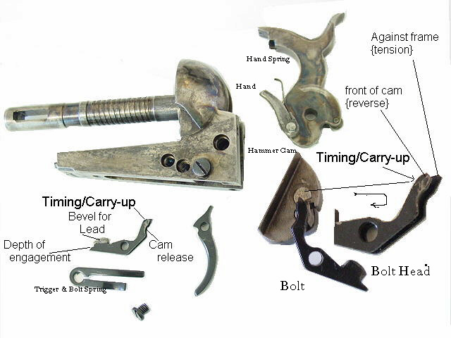

« Reply #5 on: November 17, 2009, 05:32:20 PM »
goodshot:  This diagram might be of help to you........... ;)

« Reply #7 on: November 24, 2009, 06:38:03 AM »
That's a great exploded view fourBee.
