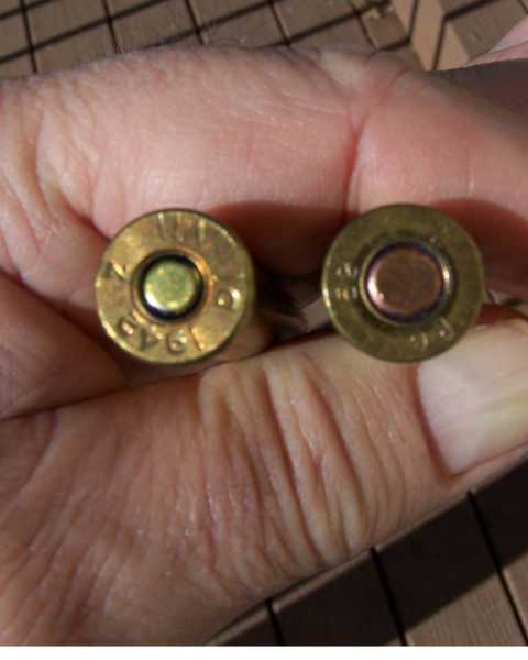

I bought a few boxes of Belmont 303 ammunition loaded with 150-grain Serria bullets.  The ammunition produced a light report, light recoil, and was inaccurate in my rifle.  There has been post or articles on other internet sites about the poor performance of the Belmont 303 ammunition.  If nothing else I consider it as cheap source of brass and bullets for this reloader.  Is the .311 diameter bullet versus the .312 diameter Hornady the issue?
I do not think the .311 diameter bullets are the key to the accuracy problem.  I measured a number of British, and Canada service rounds and they are loaded with .311 diameter bullets.  I measured commercial loaded 180-grain Federal softpoints, they are .311 diameter.  I have a full 20-count box of Santa Fe brand 150-grain softpoints loaded in military cases with Berdan primers.  I have had this box of shells for almost as long as I have had the rifle.  The bullets have a cannelure and the same profile as the 150-grain Hornady bullets I have.  The bullets in the loaded rounds are .312 diameter.  I plan on shooting this ammunition up along with any other Berdan primer ammunition I have for it because I believe them to be corrosive primed.  That way I know the barrel will get the proper cleaning for corrosive ammunition.  Plus it will be fun.  The rifle is more fun to shoot now that I have added a slip-on recoil pad.
Belmont 303 ammunition.  Last night I started pulling the bullets from the partial box of Belmont ammunition.  Field testing will determined what I will do with the remaining boxes.
Some of my observations:
1.    I used a kinetic bullet puller.  I have used this tool for many years.  The effort to pull the bullet from the Belmont ammunition was the least effort ever required to pull bullets.  Does the lack of neck tension impact ignition and accuracy of this ammunition?
2.   The bullet:  I have a foam plug in the end of my bullet puller and they were not deform, and I plan on using them.  The bullets appear to be a Sierra Pro-hunter without a cannelura.   The bullets consistently weighed 150-grains.
3.   The powder:  Is very fine grain with a large amount of gray graphite type material with it.  I poured the powder from the case to a funnel into the pan for my scale.  The funnel became coated with the graphite.  The powder did not pass the smell test.  The powders I reload with normally have an alcohol-ether odor.  This unfamiliar powder did not have this odor.  The lack of an odor could indicate the powder has deteriorated, or a different manufacture process was used.  Most of the powder charges weight 36.0 grains.  Researching .303 British loads in a number of manuals would indicate that a 36.0 grain charge of the appropriate powder behind a 150-grain bullet is at the starting side of the scale.  One case had 38.0 grains of the unknown powder in it.  In most cases when reloading rifle cases I toss the charge into the pan for my powder scale and weight each charge.  I use a tickler to bring the charge to the planned amount.
4.   The case appeared to be fine.
Two Red Flags at this time are the lack of neck tension, and light powder charge.
I disposed of the powder.
The plan is to recharge five cases with BL-(2) powder and reseat the Sierra bullet.  Before doing this I am going to run the case into the resizing die to resize the mouth of the case about 1/10 on an inch to increase neck tension on the bullet.  Hopefully test firing will give me a clue if the original accuracy problem was related to the light powder charges, and light (darn little, neck tension).  I will charge the remaining cases with BL-(2) powder and load them with 150-grain Hornady bullets, .312 diameter.
I need to re-examine the rifle to make sure it is okay.  I glass bedded it long ago, but after doing some research I am going to check and make sure the upper wood over the barrel has adequate clearance.
It has been suggested that I mount a scope of the rifle.  This is a nasty weather, close range rifle and mounting a scope of it would defeat my need.  I have scoped rifles.
Would I buy more of the Belmont ammunition at the same cost?  The answer is yes because the purchase was a cheap source of components, and as a reloader I believe I can get some use out of them.
It is time to bundle up and head for the reloading bench.  Once I get the brass loaded I have another project around the bench.  I keep thinking I have a box of 180-grain Sierra .311 diameter bullets.

Avyctes:  The Sierra bullets used in the loads do not have a cannelura for crimping.  The bullets are designed to be held by tight neck tension.  While I have dumped the powder with the box of shells I am working with I could visit another one of the boxes I have, pull the bullet, dump the powder into the powder pan, set the sizing die to do about 1/10 of an inch of the neck, re-charged the case, and put the bullet in it.
If it does improve ignition then I need to fire them over my Chrony.  I feel the charge of 36.0 grains of unknown powder is a light load.  I believe that I can gain some velocity with a proper charge of BL-C (2) which I have an unopened 8-pound jug.   By accident and reviewing the data I have BL-C (2) appears to produce higher velocity in the .303 cases within recommended pressures levels than some other favorite powders.  Using my favorite IMR4320 with the Hornady 174 grain bullet my charge weight is 41.4 grains, which is just under the recommend maximum of 41.5 grains in the Hornady manual.
The PRIMER:  I am hoping the primer is not the issue.  If I determined the primer is the issue I will pull the bullets, dump the powder and make a trip to a remote location to pop a lot of primers.  Against published recommendations I have de-primed live primers.  The problem is that these are military cases with crimped in military primers.  They are designed to stay in the case.  The only safe action I see is to pop the primers, use my Lee de-priming die, and then the Lyman tool for removing military crimps so I can re-prime the case.

Brithunter:  Was the Greek HXP 69 brass Berdan or Boxer primed?
A friend of mine was kind enough to offer up fifty loaded rounds of 303 HXP ammunition.  He did not state the year.  I held off on the offer because I think it maybe Berdan primed.  He has a military Martini in 303 and a Mark 3.  He does not reload so I sent him a picture showing the two different primers.  He lives about 600-miles from me so sending a picture was a good way to help communications.
I thought it was rather neat when he sent pictures of his two .303 rifles.  The eye catcher was his military Martini .303 after your posting on the Martini.  A rather rare sighting, then seeing two different ones in 24-hours was surprising.  The power of the internet.
Do you reload cases with Berdan primers, and if so what method do you use to extract them?  None of my priming equipment is setup for Berdan primers.  And I have not seen Berdan primers in the shop; of course seeing any primer, except shotgun, in a shop in not the norm today.
The neck tension has been fine when using my RCBS seating die.  I can guess that the lighter Belmont ammunition neck tension may have been the result of pulling the military FMJ bullet and inserting the Softpoint without paying any attention to the neck.  I suspect that in the process the neck opened up slightly creating lighter than normal tension on the bullet.  This did not become apparent until I pulled the Softpoint bullets.

HXP, all that which I have handled which off the top of my head is HXP69 of course as I brought two cases of it  :) and some HXP 83. The 69 was better quality, well I think so. It's all Boxer primed  ;).
Now you have to be careful just lookign that sizes as I ahve soem French 303, yep they had soem 303 calibre machine guns made over a period of time from the 1920's up to the alte 1930's and it has three different primer sizes all of which seem to be Berdan. Due to the stupidity of the Plods here it's all in storage as they cut my ammunition holding to about half of what I already had  ::). I pulled soem of them and found at least three different types of bullets and different powders some stick/tubular and some flake.
