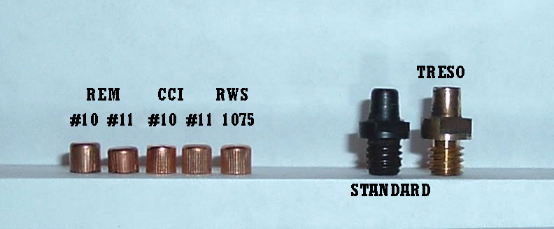

fanner50:  Here's what I mean by the Rem #10's having a long or deep cup in comparison to the other brands of Caps.  Echo4Lima makes a good point about weak hammer springs, but in the case of Rem #10's its not generally the fault with the hammer springs.  Also note the difference in Treso aftermarket nipples with straight walls, compared with the standard tapered wall nipples.
Thanks Echo ~ I got the cover from off the internet sometime back while browsing military hats, but don't remember the link.
4B

4B, pics really show the differences.
