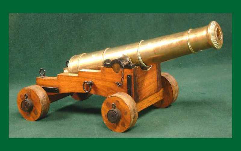

John,
That's the most cockamamie design I can imagine.
Does the anchor bolt drop through the axle tree and pass through the spindle to a nut on the outside?  It appears that the broken-off nub goes deep enough to pass the mounting bolt.
Personally, I use Titebond II in some places but not all places..
Don't muss-up the fuzzy ends and don't pick-out the ruptured bits before you have a solid plan of attack..
If you can turn a dowel to be the length of the inserted part plus enough to permanently fix in a newly drilled pocket in the axle, I might consider doing that. Score the inserted part and use Titebond there. Clamp it end to end so it doesn't expand out of the new pocket.
Otherwise, use a fat double ended screw fastener to connect the the two original but separated pieces.
After a day or so, when it is cured and the expanded glue is trimmed, insert it into from whence it came, with a top wrap of wax paper. Then white glue whatever surface you can get at on the ruptured bits (poke it in with a toothpick) and reassemble the puzzle the best you can. Then wax paper, wood block top and bottom and C-clamp. Really screwing down may realign and compress all the loose bits.
The wax paper will prevent wood to wood and glue contact.
If you opted to use the original nub with a double ended fastener, the method is the same. However, I suspect the carriage anchoring bolt may have to pass through either the dowel or the repair with the screw. Either way, you will have the drill a pilot hole through.
It's really difficult to say, without having the work in hand.
I would stare at it for a while before starting.
If you don't feel up to it and would like me to have a go at it before I start my build on the E/T of November 1st, ship the tree, axle and nub to me. I am going under ground then and will not surface until Ground Hog Day.

Rich,
I was thinking about you when I opened the box and saw the axle; I also think it can be repaired without anybody being able to notice it unless they really knew where to look. I've got "Titebond II," and "Gorilla Glue;" which do you think would be better? I was going to glue the pieces on the axle bed first, then let that cure, drill out the piece of oak dowel rod thats still in the axle tree part, and then just reglue the right size dowel rod into both the bed & tree, the way that it was originally consrtructed; no problemo!
What I don't get is; why did they make it this way in the first place, why not fashion the axle the way in which the real period carriage's axles would have been (that is cut & carved out of a sinle solid piece) constucted?
If it is waterproof use titebond.  Don't use Gorilla Glue for this type repair.  Gorilla glue expands as it cures and force gaps apart.  Gorilla glue is strong and useful to gill gaps, but not contact gluing.

« Reply #39 on: October 10, 2009, 04:01:12 PM »
Standard 2 part epoxy (the long dry stuff) should work fine, but if the axle stubs are just glued into the block of wood forming the axle
this will be prone to breakage again.  If it was mine I would consider one of two options,
1) drill through the entire square axle and use a steel rod for the axle of wheel hub  dia.
2) if you want to keep the wood dowels for the wheel hub intact I would think about boring through
    the whole thing for say a 1/2" threaded rod and use epoxy bedding compound used in rifles to secure it.
this way if it was ever dropped the wheels wouldn't come flying off.

« Reply #40 on: October 10, 2009, 06:13:50 PM »
1). If Gorilla Glue oozes out.........you used too much. The instructions are explicit. "Thin
     layer".
2). Yup! What Allen suggests, "1/2" threaded rod", is basically what I wrote about, "double
     ended screw". maybe you're not familiar with it?  I think it will work better than epoxy
     bedding a threaded rod.
They come in various lengths and diameters.  Between the two pointed screw ends, there is a space to vice grip it. They make another model with a screw on one side and a threaded rod/bolt end on the other end.
Drill under sized pilot holes in the two pieces to be joined, so that you have enough wood left to bite into. I would only drill the hole as deep as the screw end that is going into it, so that you don't drive it in any deeper when you screw in the other piece.
That's the path of least resistance. You are working with what you alredy have in wood without fashioning new pieces and the drilling is for short pockets; not extensive lengths.
I might add, that "if it was ever dropped", you deserve a swift kick in your dupa; boychik! :(

« Reply #44 on: October 10, 2009, 08:00:04 PM »
 Boom J,
 What a beautiful gun. If your house burns down (what was your address again?) and you need to sell your cannon for hotel money, I hope you'll notify me that it's for sale.
 On the damage, I think if it were mine I'd make new one-piece oak parts front and rear. The way they did it looks too flimsy to support such a heavy barrel other than for sitting on a shelf. A lathe would be nice, but I've made similar square-to-round features using just a hacksaw (at the transition), belt sander and files.
 Please post pics after you get all traces of pootina off of the barrel  ;D

« Reply #50 on: October 11, 2009, 02:02:47 PM »
I want to thank everyone for their advice, and comments, especially Richard the Kindhearted, who actually offered to repair the damage himself.
Richard has also got a good eye for wood: All the wood used on the carriage is oak, and that includes the dowel. I also don't think it was cheaper to make the axles this way, if anything it seems more involved than cutting the axle bed, and then turning the axle arms on a lathe. This "Valley Cannon Works" certainly had someone that knew how to turn wood, look at the rammer's head. I also don't think this construction method made the axle arm weaker; to the contrary this is probably stronger than if the bed and arm were made of a solid piece of wood (whatever amount of pressure caused the oak to splinter like that, I'm pretty sure it would also have cracked the arm off an axle made of a solid piece of wood). I'm wondering if they did it this way for accuracy: By that I mean the axle arms could be pefectly centered on the axle bed, and this would prevent the carriage trucks from being uneven when resting on the ground (a problem that many of us who have made a four truck naval carriage from scratch may know about firsthand).
The reason that I'm probably going to eventually make the axles from a solid piece is because it would be authentic to the way the real axles were made, and I'm also going to drill the holes in the arms at an angle so the lynchpins are raked back.
For now I'm going repair it kind of like R.C. recommended, only change the order of which piece is glued first. I'll glue the bed that's splintered first, (using Gorilla glue) because I want the expanding nature of this glue to fill in any voids left between all the pieces when I try and work them back together. There are also
cracks down the center of the bed that you can't see in the pic, so I'm going to have to place two small nails on either side to open the split up, and then I can work some glue in the splits. Then I'll clamp it all up, (good idea on the waxed paper R. C.) and let it dry completely, and just clean up the dried overflow on the inside of the bed with a drill bit. From here on out, I'll switch to theTitebond II glue, the next step being to glue a new oak dowel into the bed, and let that cure. Then after I drill the remaiming bit of dowel out of the axle arm, I'll be able to gauge how much of the dowel to saw off to get a tight fit between the bed face,and inside face of the axle arm; then glue, clamp, wait, unclamp, sand a little, and refinish.
I don't want to go the route of having a steel rod all the way through the axle bed, but even if I did, the two key bolts coming down from the tops of the cheeks, that go through the axle bed, and are secured with nuts, would make doing this a little problematic.
