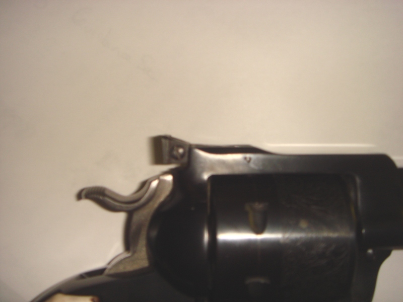

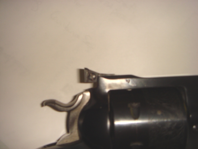

A while back I had John Gallagher build me a custom Bisley Blackhawk with a 5.5" barrel to my specs and he did a wonderful job.
I have started to play with it some and am having trouble getting it sighted in.
My load is not as hot as what he used to test it before he sent it to me.
I load a 255gr hard cast SWC over 12.5gr of HS6 which should have me about 800fps, a very pleasant load.
The problem is it prints about 5" high at 25yds and about 2" to 3" left.
This is with the rear sight screwed all the way down and slid all the way to the right.
What he was loading was a Hornaday 250xtp over 21.5gr of 2400 powder at around 1300 to 1350fps and that the sights were set for that load.
None of my manuals even list a load that high with 2400, 21gr max.
I really don't think I want a load that hot for everyday shooting.
Maybe around 1000 to 1100fps wouldn't be to bad, tops.
The sights are a Bowen adj. rear and a S&W style ramp with a red insert front that measures .250".
Would a .300 make enought difference to lower the POI for the load I am currently useing, or would I still have to step my load up some?
I know no one knows for sure, you just have to switch the front sight and give it a try.
I was just asking to try and determine what I need before I order something that won't work.
Thanks for any help you can give.

Longtom, I think you should try .350 to .400. I don't think that extra .05 is going to give you enough. And you said you already had the rear sight is screwed all the way down. Not sure if anyone makes a taller front sight with an insert. What we use to do for our silhouette pistols, is get an extra tall front sight, say .500, bring the rear sight up about 6-8 clicks off bottom, and start filing off the front sight till we got on target. At least you had a few clicks to play with on the rear. But, this would only work if you had a front sight that didn't have an insert, and was basically a patridge design with a back cut. Good Luck!! gypsyman

I have shoot 21 grains of 2400 with the 45-270-SAA cast boolit.  Tha slug weighs in at 283 grains, BUT, it is cast and may accept a bit more powder charge than a jacketed bullet...
I think something else is wrong if you are out of sight adjustment.  My Blackhawk just has the factory adjustable sights and there is nothing that I shoot that I can't get on target with the adjustment limits of the factory sights.  That includes light loads, heavy loads, cast, jacketed etc...
Something just doesn't seem right with the sight system on your handgun...

The point to my post was that I don't think that no matter what load is shot through that handgun, he will not be able to get the 5" high and the 2"-3" windage solved since that is the best he can do since he is out of adjustment on the sights...
Something is out of line with the sighting system...Just my thoughts...
The handgun may need sent back and a request made to make it shoot closer to point of aim NO MATTER WHAT LOAD IS FIRED THROUGH IT--PERIOD.

Sorry guys, I was away this evening at my youngest sons football game.
They won 22-8!
Anyway, I did state the loads I wanted to use and they were from about 850 to about 1050 or a tad more but not 1350fps.
I chose the sights but he chose the height.
I knew that my plinking load would be off some but didn't think it would be that much as far as height.
Not sure what is going on with the windage.
Maybe it's the way I am holding it that is causing the left of POA.
I contacted him about the problem and he said I needed a hotter load but he would send me a taller front sight.
Never got one!
Tried to contact him a couple of times but got no answere.
As far as sending it back, if it is something I'm doing wrong or just the load I hate to pay another $69.00 for nothing.
I thought I would try a few things first and if that didn't work then I would have to.
I am not afraid of recoil so if I have to step it up that much then I will, just not what I was really after.
Like I said, I will try a lighter bullet and or a stiffer load and see how close I can get height wise.
Work on one thing at a time.
Next I will address the windage problem.
I may load a few rounds near his veloicity and see where they print just to see if indeed he was telling me right.
Today I did notice that the front sight has a very slight wiggle to it.
The slot apeers to be a tad wider than the sight itself.
I guess that could account for some of the windage problem.
Not sure it would make up that much though.
The only thing I don't know is at what distance he sighted it in at.
I did try a few rounds at 7yds and they were very close to POA.
Great for close up protection but again, not what I was after.
I will beat this, just may take some time.
Thanks for all the advice and please feel free to suggest any and all you know.

I agree, even a fixed sight single action shouldn't be off that much.  You're right.

I wouldn't think it's the way your shooting.  You seem to be an experienced shooter and when you think about it, just about anyone should be able to shoot a sixgun right off with somewhat decent accuracy.  The fact that you're grouping in one place or another shows that you know how to shoot it.  I definitely think there is something wrong with the sights.  It's a shame that for the price one pays for a sixgun like yours that you're getting the runaround.  Rest assured, it should shoot well.  I haven't found a standard Ruger Blackhawk that I can't shoot fairly well with out to 100 yards, there is definitely NO reason that a custom revolver like yours shouldn't do the same.
Good luck, I hope you can work it out.  Now that I think about it more, I'd work more with the maker rather than the load.

rawhidekid:
I assure you the sight is all the way down.
This is a Bowen classic sight and seems to sit a little off the frame but the sight is screwed down tight.
This is all the way down.
This is all the way up.
Note the distance between the bottom of the sight and the top of the hammer and the piece just ahead of the windage adjustment screw on top.
Better yet, just look at the windage adjustment screw and you will see that it is all the way down.
LONGTOM

Offline rawhidekid
  • Posts: 679
Re: 45 colt & 2400 powder
« Reply #18 on: October 07, 2009, 07:59:56 PM »
Ok, I now see what you have, but there sure doesn't seem like much movement comared to mine.  Sorry cant show pics as no digital camera, although one is on order. ???  But if you are not satisfied shouldn't you return it for warranty repair to the customiser?
