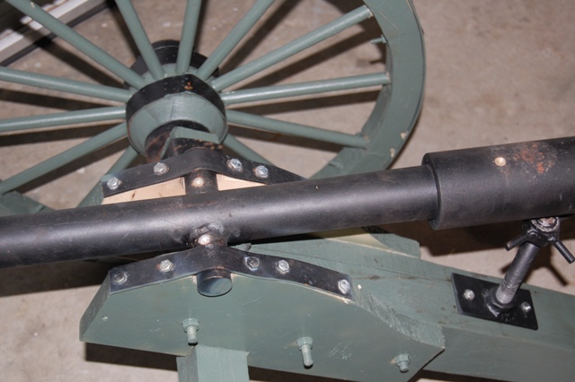

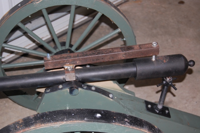

I built a sight "frame" for my Parrot Field Rifle.  I created 3 deep "dimples" with a 3/8" drill bit and the legs are made of 3/8" threaded rod (one on each side of the trunnion and one just in front of the fuse hole).  It is a very sturdy sighting device and is repeatable, no play whatsoever, it is removeable just by picking it up, so that the cannon looks authentic when actually fired.
It has proved to be very accurate, considering what I'm using as "sights".  At this time all I'm doing is lining up the front bolt with the rear nut.  At 350 yards I'm hitting within a few feet each time.  Attached are pictures of the apparatus.  I need some help designing some sights to go on it.  It is adjustable for elevation, but the windage will not move, so the actual sight would really need to be adjustable for both.
Let me know what ya'll think.  I could always mount a riflescope on it - I think it would be best to use Leupold style mounts with adjustable windage, but I would think that a tang type sight with a peep would be great.  Any ideas on designing one?

If you want the best "period" correct sights for a Parrott you can't beat the Stadia rear sight with a rim base mounted front sight.  This will give you a nice rear peep with windage.
I have used crude breech sights (at least compared to the Stadia) that you have to hold in place on top of the breech each time when sighting and have done very well at long range.  Windage compensation is accomplished by pointing off target, sometimes way off target to compensate for high winds and drift.  This is the art of artillery and knowing your piece...
However, from the picture of the barrel, carriage, & sight mount historic accuracy is not a factor on this piece, so having the ability to mount convention sights and/or a modern day scope on it might be a cool option.
Don't get me wrong, I am not saying anything is wrong with your piece or what you are doing, all black powder shooting is fun and it is ALL good as long as it is done safely, I am just more of a purist when it comes to replicas~   Anthony

is this a rifled barrel ? i'm guessing it is .
mount a scope on that 3 point ...piece .
if nothing else just some old adjustable sight and front sight post mounted on it .........simple .
REMOVE it  ! shoot it see if it does what you want ? looks like it might be accurate .

 NitroSteel,
 That looks good. There was someone on here who made a similar one but rather than dimples, I believe he just set the screw tips to register on the trunions and rear of the barrel, with a stop attached to the frame to locate on the cascabel.
 I'd go with a scope. Brownells sells flat base blank aluminum Weaver rail stock in various lengths. I think I paid ~$10 for a foot long piece a few years back. A simple setup that's windage adjustable could be made using that; just put a hole through the front end of it for a screw where it could pivot on top of your frame, and a small toe-clamp at the rear so you could move the rail left/right and secure it so it couldn't move after you got it set.

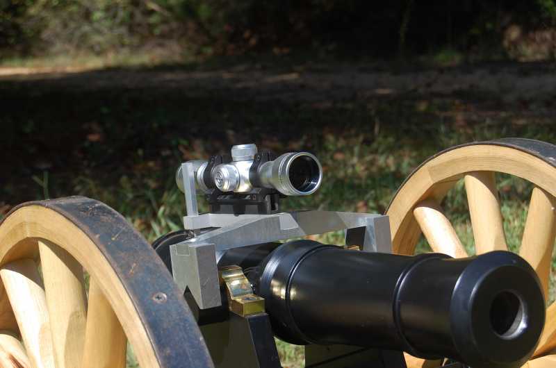

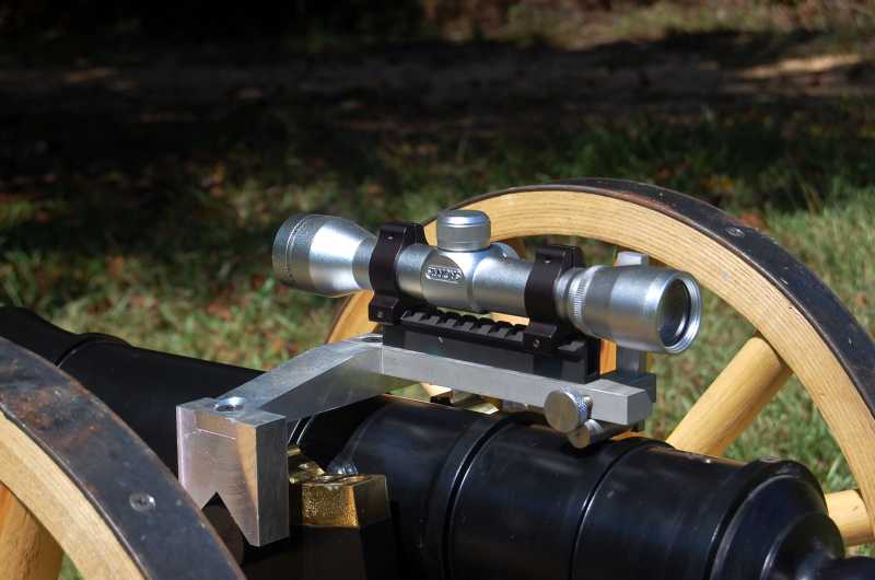

   We are glad to see that several of you have made these "easy on, easy off" sight bases for iron or scope sights.  Terry C. of Waycross, Georgia also made a real nice looking and functional one too.  We have been using ours since 2004 and have no complaints.  Here is a photo of the only style we have made for ourselves and several customers.
AND, if you want to see the math and logic behind making one of these you can check out the original thread.  Click on the link below.
                               http://www.gboreloaded.com/forums/index.php/topic,128706.msg1098468224.html#msg1098468224
     You see, Nitrosteel, on your next cannon you can have real nice looking, authentic sights and then build one of these "contact point sight bases" for shooting and avoid drilling ANY holes in your fine looking cannon.  You will have the best of both worlds.  Although we said this in the linked thread, it bears repeating here:  The accuracy and repeatability of the sight base style we, Dominick and Terry C. built is quite good and has been measured by the old aerospace inspectors, us, to be position repeatable to .0001" each and every time we mount it on the cannon's tube.
Let's see some shooting results!
