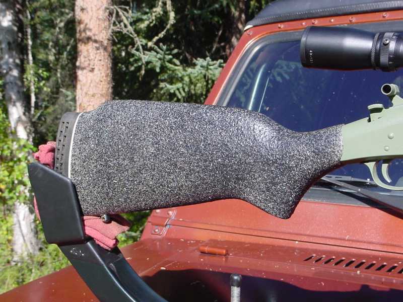

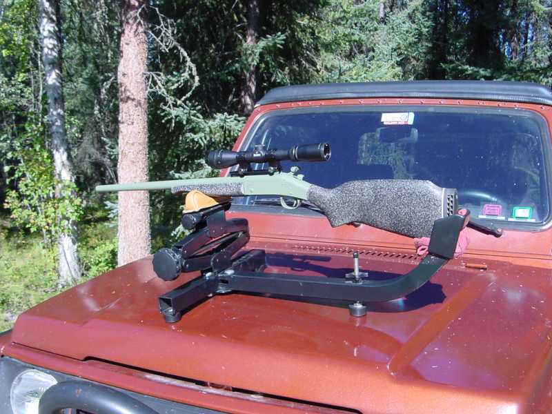

I would not use bed liner, too heavy and thick.  I recently had it sprayed on the lower portion of my S-10 pickup.  We live out a gravel road and the big tires were throwing gravel to the point it had eaten all the paint off behind the wheel wells.  No way I would put that on a gun.
Now I did use the Rustolium Textured paint on the metal surfaces of my 30-06.  Stopped the rust, and makes the gun easier to handle with slick or bloody hands.  I also used the Rustolium Accents paint on the wood.  Makes the wood look like stone, is real rough and also helps in handling with slick hands.

Thanks sourdough.  Ill have to try that.  That is one purdy rifle you got there.
