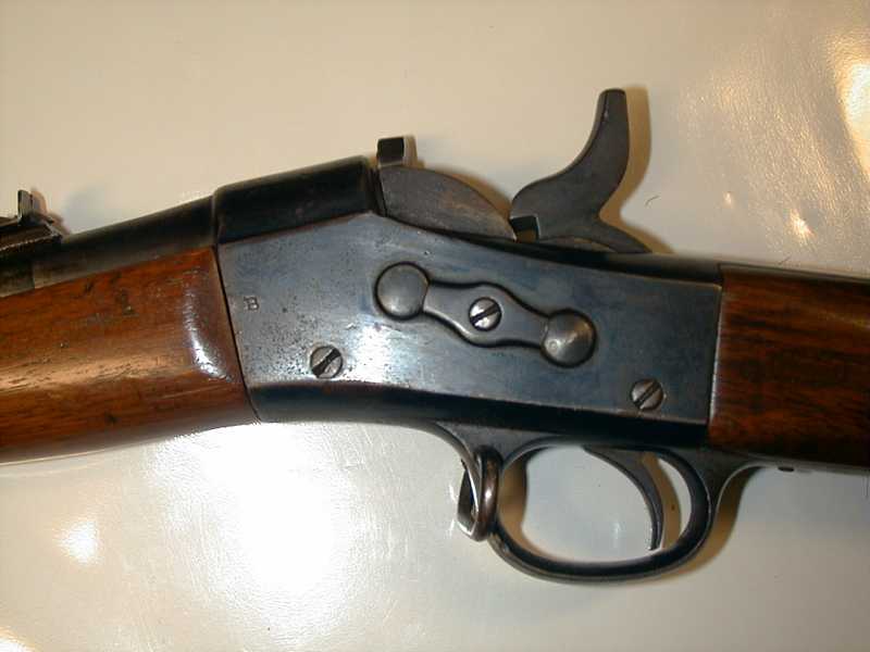

I have a rolling block rife that needs a new barrel.  It is marked:
REMINGTON ILION NY USA
PAT MAY 3D NOV 15TH 1864 APRIL 17TH 1868
AUG 27TH 1867 NOV 7TH 1871
Other than a B on the left side of the receiver, I cannot see any other markings.
Can anyone tell me more about it.  It is a centerfire, BTW.  I  would like to know what calibers would be appropriate for that action.

  These rifles were usually chambered for rimmed black powder cartridges such as the .45-70 and .50-70. A huge percentage of them were chambered in .43 Spanish and .43 Egyptian.
  If I were going to rebarrel, I'd go with one of the classic .45 or .50 caliber cartridges. Some target shooters  like the .40-65, too. This appears to be the earlier action, and I'd stick with the earlier cartridges rather than the later high pressure stuff.

The 7mm R.B.s came along late in the model's life. That appears to be an early black powder era action. A lot of the 7mms had a hand guard and there doesn't seem to be provision for one on this rifle. Most of these are found in .43 Spanish, .43 Reformado, and .43 Egyptian. The Egyptian rifles often have the worst barrels.

There are so many variations of "black powder" and "smokeless" actions, not to mention the parts guns and actions rebuilt by others from whatever parts were around, that you really kind of need to have a 'smith that knows Rolling Blocks take a look at it. Some quick indications of whether it's a smokeless action would be the extractor and the firing pin hole in the breech block. If the barrel were pulled you could tell for sure. There are differences in some parts between the "smokeless" and earlier "black powder" actions though many of the parts will interchange. Either action is great but for different uses. I've built a number of .38 thru .50 cal cartridge guns on the earlier actions. Best, IMHO though, is the 1897 and later actions in 7X57 and I like those with rotary extractors best. .30-40 Krag is an excellent choice for a small bore that shoots cast bullets very well and I enjoy shooting and hunting with it. 7X57 would be great as well but I think rimmed cases work better in Rolling Blocks than rimless. I set the barrel back on a friends 7X57 as the chamber was rough. The chamber was recut for 7X57 Rimmed and the extractor changed. He bought some expensive foreign brass but it can be formed pretty easy from .444 Marlin. Might be a tad short, I just don't recall. Be aware that there seem to be some differences is chamber size between SAAMI specs and what you might encounter in an original 7X57 chamber. Full power loads and full length sizing will likely lead to short brass life and possibly some excitement and head (case, hopefully :)) seperations. There have been some very good articles written on this over the years. I recall an excellent one on cast bullets in the 7X57 Rolling Block - Campbell was the author if I recall and I think it was in Precision Shooting or The Accurate Rifle.  There is some good Rolling Block general and gunsmithing info in DeHass book on Single Shot Actions and the NRA Gunsmithing Guide. I imagine volumes could be written on the Rolling Block and gunsmithing it. You could probably spend alot of time just tracking down all the info on the web on shooting and building Rollies. A worthwhile venture. 'Course if yours is in good shape, find out what it's chambered for with a chamber cast and get to shootin' !

I sent the pictures to a gunsmith who specializes in RB, and he said it is a New York State 50-70 or a Navy 50-45.  It is definitely a black powder model from the firing pin.  It has the decocking system when the breech is opened.  The present barrel was from an '03 according to a local gunsmith.  I will have to look for the cast of the chamber, but if I remember right it was Mauser dimensions, but 30 cal.  I tried to make the brass from a .444 and actually fired it once.  The fired round measured out to a 7.62x57, but this was a year or more ago, so I may not remember correctly.  The cartridge would not eject, so I got discouraged and I went on to other projects.  Now I want to play with this again.  Maybe the extractor could be altered?  If it would extract the shell, I would have no problem making brass and shooting cast bullets in it.  It sure would be cheaper than rebarreling.

I've got one just like it, although that one seems to be in much better shape than mine. Mine is a 50-70gvt caliber. All original, the bore looks like a freshly graded gravel road. Cool old guns. Never fired mine. I inherited it from my dad. He did order some ammo for it years ago and shot the rifle a few times, but I still haven't nutted up and squeezed the trigger on it.
Never knew there were so many different caliber options. Learning more and more about this rifle all the time.
