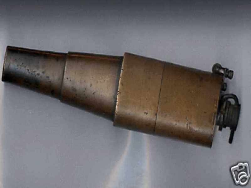

I know this doesn't meet the criteria for large, but I thought you might find it interesting. It was on ebay a few years ago, and its only 10-inches long, but it caught my attention because the machinist evidently spent some time fashioning the thing. There were a bunch of pics, but this is the only one I saved; the ignition system was a small spark plug hooked up to a battery, and it also had some kind of automatic feed thingage attachment that fed the right dose of carbide powder into the water chamber. At the time, it kind of intrigued me, that someone would put this kind of effort into making a one of a kind carbide cannon.

 Wonder why it was made flattened like that? Do you remember if there was a water reservoir on the bottom?
 I was thinking to use a modified piezoelectric BBQ ignitor to light the thing off. Maybe with just a simple capped fitting on top to dump the calcium carbide in.

Victor, its not flattened, the barrel is round, but I enlarged the pic to the max on my photo hosting site, and sometimes the images get distorted. The water reservoir was in the wide rear part of the barrel, and the line you can see there was where it could be unscrewed apart, (I guess to clean it out, if needed) and the spark plug screwed into that part coming out of the breech.

 Okay. I thought it might just have been a fig newton of my imagination, but it did look kinda squashed.
