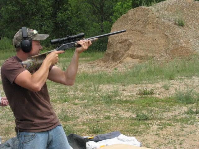

It's the stock design.  Look at the line of where the stock rest on the shoulder.  Then draw a line through the metal part of the rifle to see where it intersects the shoulder.  Notice it is above the stock, hence the jump.  You can see that on the pictures shown by .17HMR right here in this thread.
I changed the stock on my .35 Whelen to a thumb hole design that lowers the alignment of the rifle down to the middle of the shoulder.  I get no jump what so ever.  It does make getting behind the scope a little harder, have to flatten my cheek a bit.
