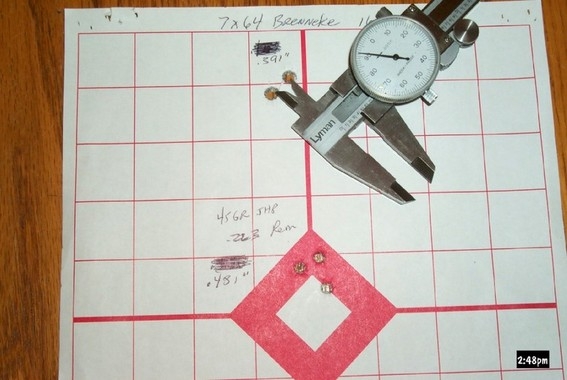

« Reply #5 on: July 31, 2009, 05:17:59 PM »
The factory standard is 2" 3-shot groups at 100yds with factory ammo, but with the right ammo or handloads, you'll get under 1" easy, mine does it with the Winchester white box 45gr JHP.

Re: New Thumbhole Handi rifle in .223
« Reply #7 on: August 01, 2009, 06:19:14 AM »
Go to the FAQ'S check out barrel break in and you'll be shootin this or better. 1st one is 100yrd second one is 200 yards .223 Blackhills 55gr soft points I got some hand loads that are a little better if I'm right in good days but these are minute of Prairie Dog off the shelf. Check THE FAQ'S. Kurt
