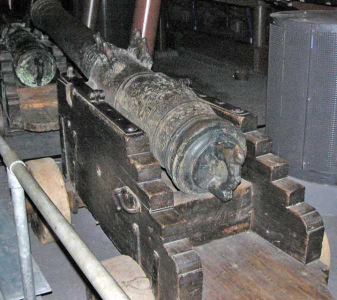

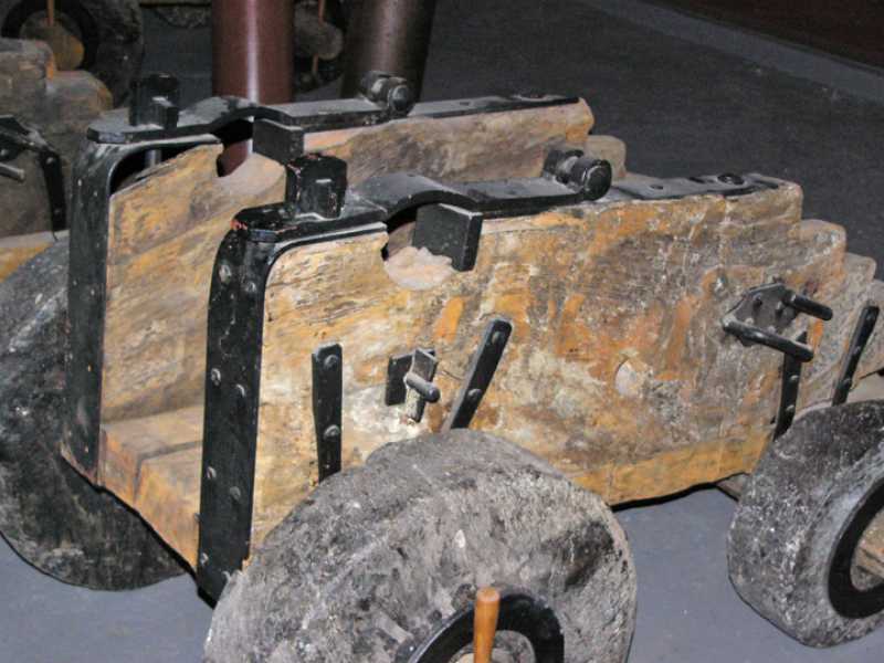

the top photo there is one of the original carriages except for the hardware,
the bottom photo is a museum reproduction .
