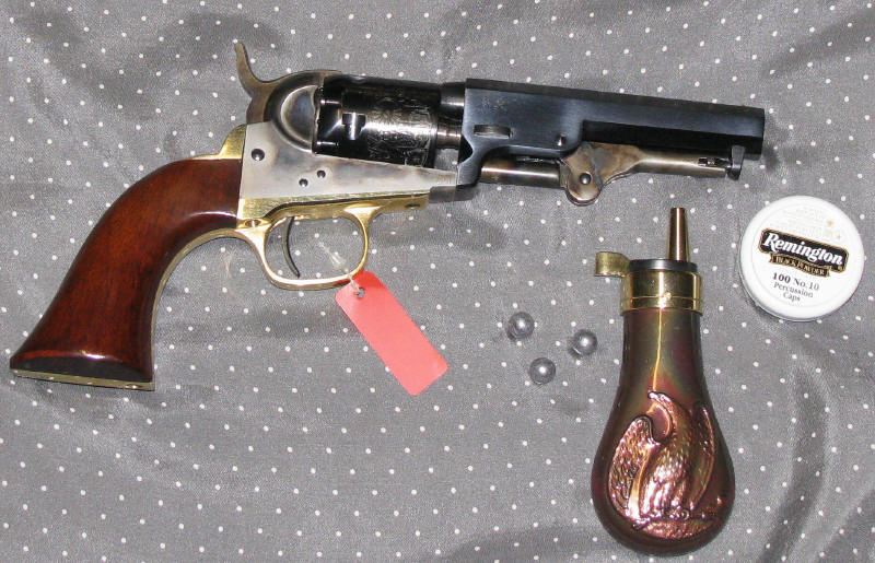

How Cabela's Uberti 1849 Colt Pocket handles right outa the box.
I would not have wanted to shoot it right out of the box because I found.......
The Loading Lever and Ram connection had a couple of burrs that caused it to hang occasionally on the downward thrust, and one of its screws was loose.  A little buffing cured that.
Breaking down the gun for cleaning the grease and new shavings out of it, I found the trigger guard screws loose.  Only 2 of the 5 cylinder nipples were tight.  The left side of the hands neck had been filed and was ruff.  A few brushes with fine grit sandpaper took care of that.  The Frames Hammer Slot had a nice burr on one side facing the Cylinder.  I did a little extra buffing to smooth up the action and put it back together.
 No big problems, but what I found could have made the gun inoperable on the Fireing Range.         Now she's ready to go shootin. :D

FourBee - that's a nice looking pocket model and I'm sure you are going to have LOTS of fun with it - yeah, I'm jealous as well!  I'm glad you were able to get one and look forward to hearing what  you think of it after you've put some rounds through it.
I went to Cabelas last summer when I was in Michigan to get one.  It, as well, was an Uberti.  The store only had one in stock and when I handled it and looked it over, it was pretty nice UNTIL I cocked it and tried the loading lever.  The action felt like it had ball beaqrings mixed in with it and the loading lever hung up as well - all due to burrs I'm sure.  I have built and worked on muzzleloading rifles for years and have no problems with adjusting locks, etc. but I feel like a duck out of water when it comes to "pistol smithing".  Therefor, I backed off on buying it and got a Pietta '58 Remy Navy instead.  The quality of that pistol was fantastic - perfect timing, perfect finish, nice trigger pull, etc.  The only complaint I had on it was the fit of the grips but from what I hear, that can be a problem with Piettas and I can easily fix that.  I love the Navy!  My point is . . . I couldn't believe the difference in quality between the pocket model and the Navy from the two different manufacturers.  Maybe the one I looked at just didn't get the quality check it should have.  I, as well, would hope that Uberti would pay more attention to the "burr" problem.  Ignoring my one experience though, you have a great pistol and you have the ability to "tune it up".  I just need to sit at the bench and take my pistols apart and get more familiar with them - and hopefully not have any "spare parts" left over.  ;-)  Lots of great tips and help on this board though so I just need to make the time to do it.  Good luck with the pocket model and let us know how she shoots!  Thanks!

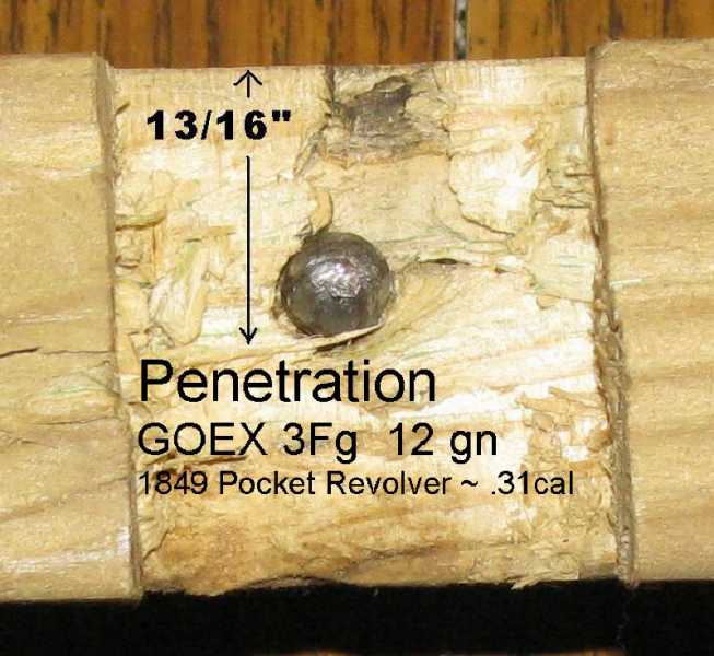

For the penetration test I used a piece of  2x4" treated pine.  The ball kept its form as it sunk 13/16ths  of an inch into the wood and moving downwards just a bit at the end of its path.
