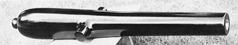

 Boom,
 The 3" ordnance rifle is about the only barrel I'd dare describe as 'sexy.' A beautiful shape.
 Note the contour of my micro-gonne...
 On a larger scale though, I think an ordnance rifle might be time consuming for me to do well without a CNC lathe. On a conventional machine it would be more of a 'wood lathe' type operation; a lot of manual shaping with a hand-held belt sander to get the large radii and smooth transitions. The trunnions would also add quite a bit of welding and grinding time to make look good.
 I'm not bad at doing such things, but a slightly clunkier shape that can mainly be cut with tool bits and minimal hand-shaping is more of what I'm looking at.
 If I had the time though, it would be really cool to make a little one...
