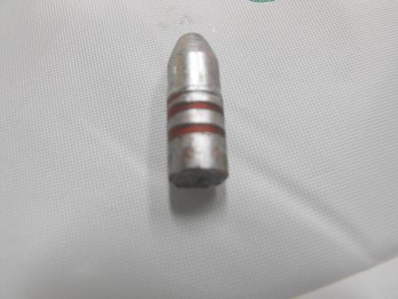

thank you for you input  -- If I goof,. I'm out $25. and will have some parts still good  -- I found a 160grain .308 onehole that I hadn't  used in years.
     I gound with a dramel then lapped,, Cast  5 boolets. ground a little more laped
 I used lamp black on the mold to see what I ground
Cast more,,,  time to run though resizer...I'm not looking for perfection just something that work.. can I do it at home..I'll know when I shot them..I may need to remove more but I went out and shot a few and they seamed  to do  good
