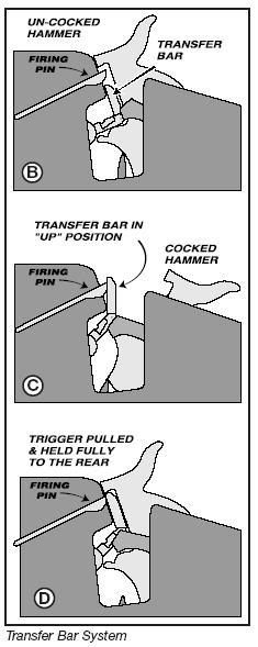

Maybe a visual aid will help...?
Bill

Thank you LaOtto222 and Bill, after looking at the diagram, I now know my Handi Rifle does have a transfer bar. This means that when the hammer is un-cocked and at rest, and the trigger is released, my transfer bar is staying in the up position.
I sent the gun (minus the barrel) Priority Mail to H&R this morning to have the 45/70 Gov't., installed and they can fix the sticky TB and replace the FP too.
