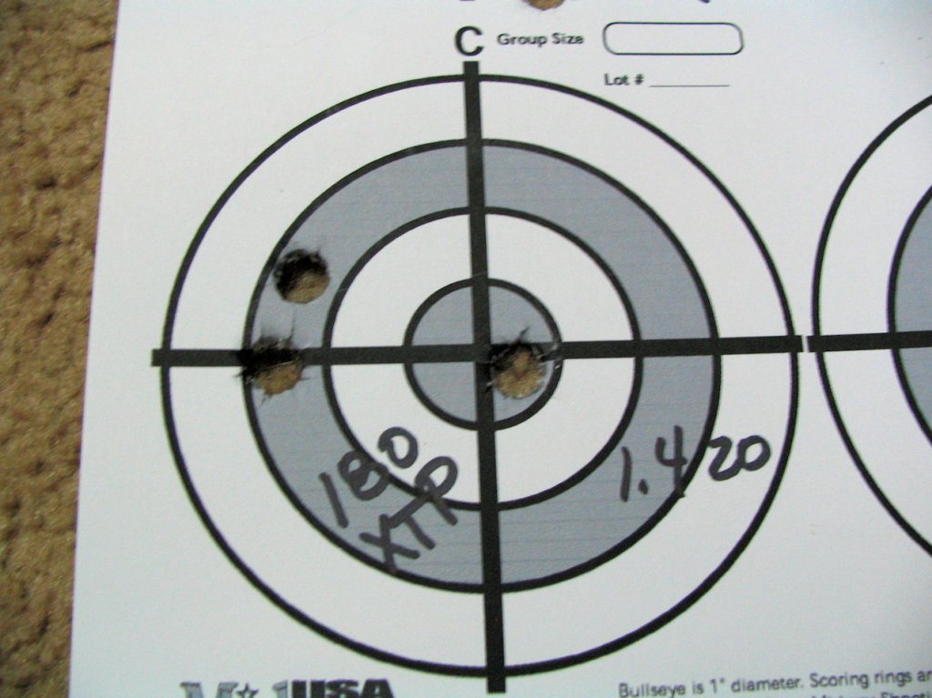

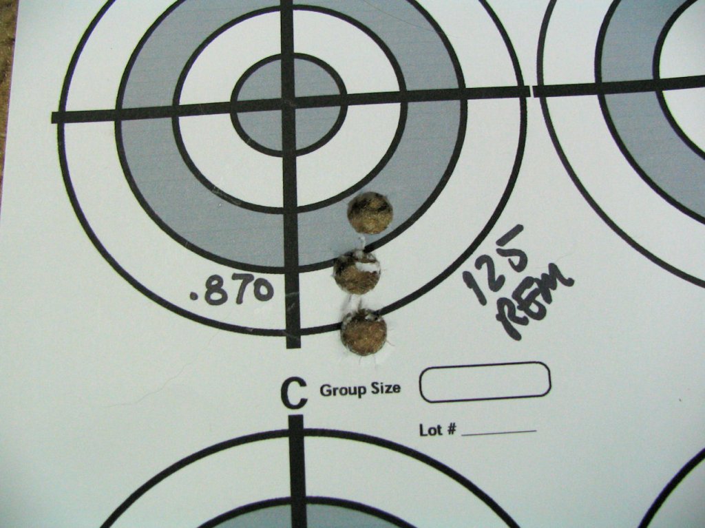

I have used 125 grain bullets over 23.0 grains of W296 for a pest/varmint/plinking load. I get around 2300 fps with it and it is not high pressure. I get a lot of soot on the case because it is not high pressure. At 50 yards I get 3 bullet holes like they were stacked on top of each other with a 2.5 power scope.

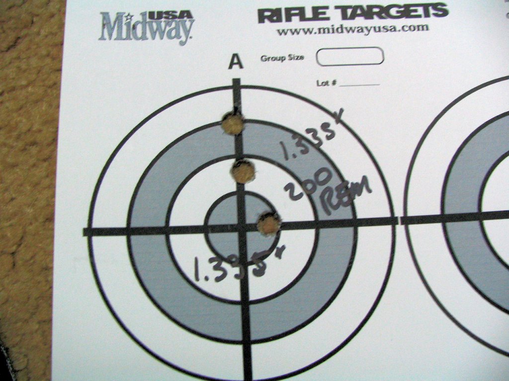

These were crimped, the next batch I am going to load the same with out crimping to see if it makes any difference. It could make it worse, I just have to try it. I tried to up the powder to see if it would do better, but it did not. I read some where that the light pistol bullets if pushed too hard will deform and not shoot worth a hoot. I think I have confirmed that, but 2300 fps is not too bad for what I intend for them. I have done some work with heavier bullets, but not a lot. here are a couple of more loads shot at 50 yards with the same 2.5X scope
I need to work on it some more - I think I can get it down to 1 - 1.5" at 100 yards with a little more load development or a different bullet. I have some others to try. I now have 180 grain Remington and Hornady 180 Grain SP SS/PB interlocks to try. I want to try some AA1680 and maybe some TAC. I can not remember for sure, but the ones shot with the 200 and 180 grain bullets were with either W296 or Lil'Gun. I do not have my load data available right now to look.
