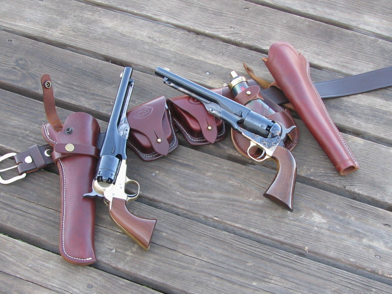

                     Brass Frame !    Okay; they're fun, but remember keep the powder charge at 21grains of real black powder (GOEX fffg).    Continuous, I said continuous use of high charges(35grains) will wallow out those brass frames, but with responsible care it will last a long time.  My brass below is about 15yrs old.
Even with a steel frame, a charge of 21grains of GOEX fffg under a wad gives (in my opinion) the round ball its best combination for accuracy.
