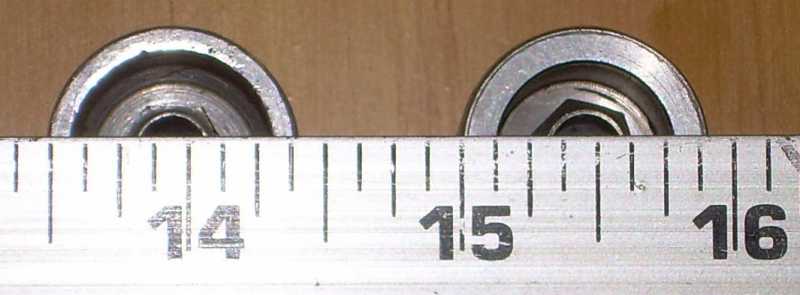

#3. Would an older .58 cal. Huntsman ,equipped with the real old slip-in breechplug, be capable of  boring/ tapping for the NEF/ Metrics improved breech plug?   Ken
Dunno' about definite answers to the other questions, but as for #3, if you look at this pic of an OEM push-in and a Hubbard's replacement I believe the answer would be "No."
Note however that they both wear carrierless Hubbard's 209 primer holders which are fully compatible with the old Huntsman and its push-in plug.

  It sure looks like you're right on the .58. , so I'll erase that possibility. I thoroughly checked that other site ,but couldn't find any rifling info . I did ask about it though and I'll wait and see if I get any response. Thank you for your help,   Ken

The breech plug on the pop in plug for both the .58 and the 12ga is .923 +or-... the screw in plug for my other .58 is .874 +or- so you would not be able to tap the push in gun for a 7/8" threaded plug with out plugging then reboring to tap.
