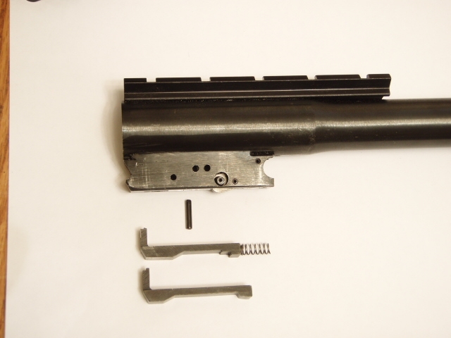

An ejector won't work in an extractor underlug unless you add a short spring or an extension of some sort to the works, it's quite a bit shorter than an extractor, the retainer pin is also in a different location, so it either needs to be relocated or the ejector thinned to match the extractor profile.
Ejector on top

The short spring I add to ejectors when I convert them to extractor will work, you end up with a spring backed up extractor, the extractor cam compresses the spring, if the case sticks, it ejects, if it doesn't stick, it just lifts the case out. Spring length and size is critical tho, it must be long enough to push the case out, but be able to compress and become solid in case you get a sticky case. The pic I posted earlier is an ejector underlug converted to an extractor, the ejector claw(top) is shown with a short spring that sits between the extractor cam and the end of the ejector.
You may be able to just shorten the extractor a little, just enough to add a short spring that will hold the case against the breech face as Larry mentioned but the extractor post still needs to be thinned so it doesn't hit the breech face before the case does, otherwise it will allow more headspace, on top of the primer being slightly recessed, you may still get misfires. Older ejector barrels had deep rim cuts too, but the ejector spring held the case against the breech face so it wasn't a problem.
