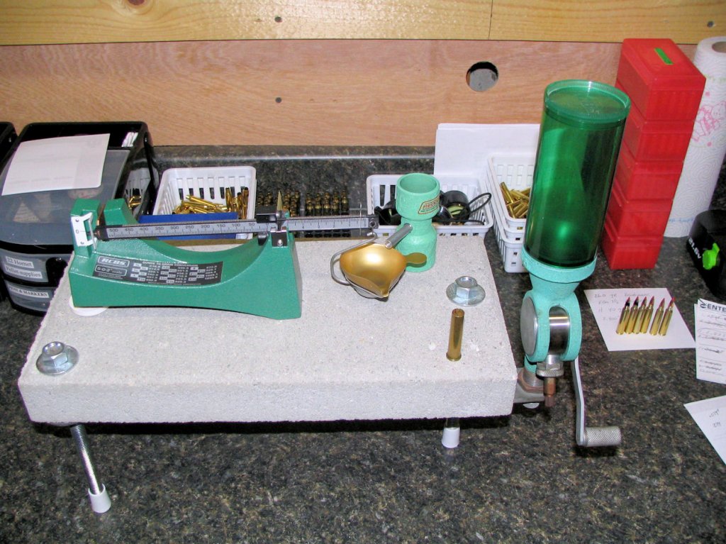

I have an old Uniflow. I bought it used about 30 years ago. I set up my scale for the weight I want. I then adjust the Uniflow to a weight a little below the weight I want. I then throw the charge into a .375 Winchester case that has a spent primer in it tight against the bottom of the metal spout. I then dump it into the pan. I let the scale settle and then trickle in the pan until I "zero" out. I use a Redding trickler. It is not as quick as going directly into the case or even throwing the exact charge, but it serves my purpose and I do not have to worry about bridging and throwing a short load. For one thing, I enjoy my time at the bench and get a little satisfaction from making sure I get the exact amount needed every time. #2 - I am a little fussy about my reloading. #3 - I do not reload for any semi-autos. I load for single shot guns for the most part and a couple revolvers - a 357 S&W Model 66 and a Virgina Dragoon single action in 44 Mag. My other hand guns are either T/C Contenders or rim fires. All my center fire rifles are single shots. So volume is not a big deal with me. I have got a RCBS Charge Master 1500 about 2 years ago that sped up my reloading some, but I still use the method described above for small volume (light weight) charges, especially Unique. Good Luck and Good Shooting
Here is a Pic of my set-up

that is pretty much the way I have been doing it too and it works for me.  I too am reloading for single shot rifles and the 357 so volume is not as important with me.  I think it will be a matter of practice and getting the technique refined so that I can produce consistent rounds for both.
I like the deck thing that you made to set up the powder measure and the scale, I may duplicate that one. right now the scale is mounted on a shelf at just about eye level but I am not happy with the slight movement in that shelf for either the scale or the powder measure.

Jal5 - I just bought a cement block at the local lumber yard (2"X8"X16"), 24" X 1/2" all thread (three 8" legs), rubber cups (glued on), 1/2" rubber washers (go on bottom of block) and some 1/2" washers and nuts. I think it cost some where around $10 or so. Took it home and drilled the block for the 1/2" all thread and cut the all tread to length, (depends on your application how long). I later added the Uniflow to the mix. I drilled two through holes and used concrete screws to mount it up with (can be seen flanking the 375 case). It is very solid and not wobbly at all, it stays put too (read heavy). It gets the scale right up at eye level when I am setting down. I bought an extra block, thinking I could use it if I cracked the block during drilling or make it two blocks thick to add extra weight. I did not crack the block and I did not need the extra weight. Good Luck and Good Shooting
