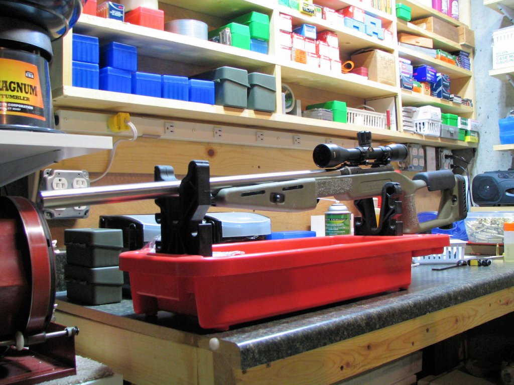

I am finishing my latest project. It is a 223 with a Stevens 200 action, Shilen Barrel, Choate "Ultimate Sniper" Stock, Rifle Basix trigger and Bushnell Elite 3200 10X scope. I added a SS BT style bolt handle and a SS recoil lug from Sharp Shooters Supply in for good measure.
Here is a pic of the whole rifle
Another pic with a rakish angle

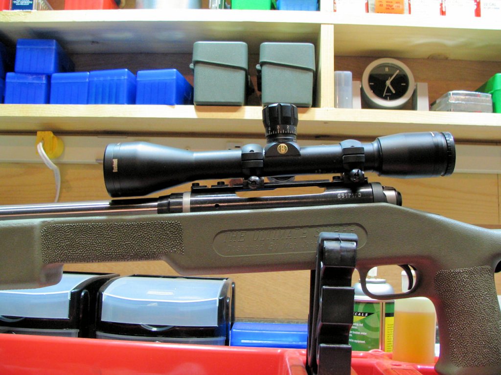

Here is a pic of the scope - notice it is mounted low

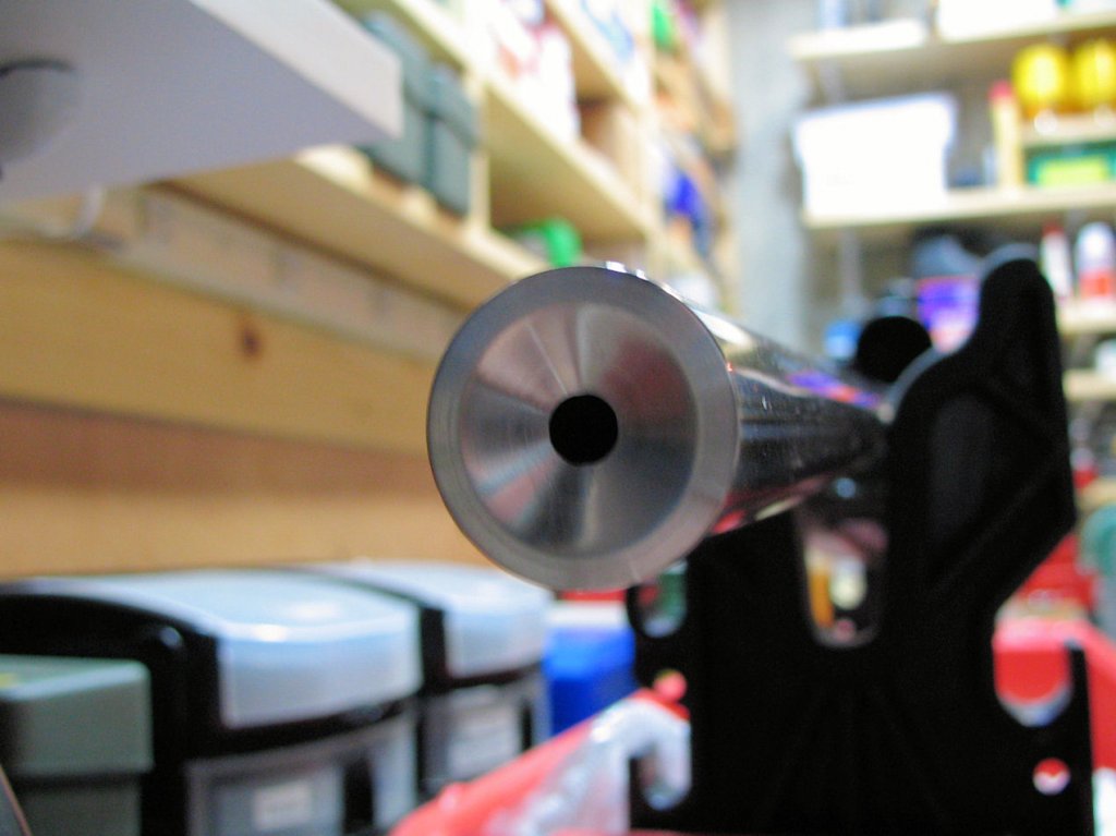

Here is a pic of the muzzle - target crown
The Action was worked over by Sharp Shooters Supply. The Shillen barrel is a 26" Bull (1" muzzle diameter) 1-14" twist, ratchet rifled (4 lands), the chamber has a .246" neck and throated to my dummies loaded with 40 grain Hornady V-Max bullets.
I almost went with 1-16" twist, but I wanted to be able to shoot 50 - 52 grain bullets if the 40's did not work out. I am hoping for 3800 fps with 40 grain bullets.
I have just got it together and the weather out side is frightful, so I do not know when I am going to be able to get it on a bench to try it out. I have got 500 virgin LC 06 cases prepped for loading. This included turning necks down to .243" - they should be .244" once a bullet is seated.

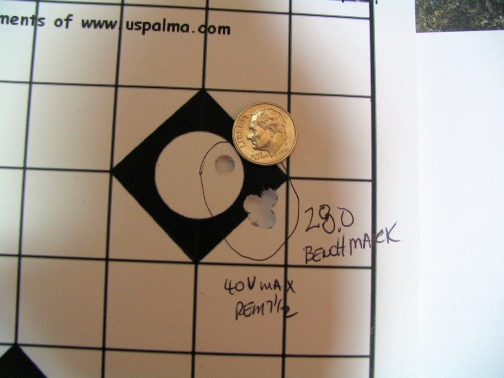

Here is the last group I shot with 28.0 grains
I know I pulled the one shot and like I said the rest was wobbly left to right (a lobed bag stacked on top of 3 sand bags just does not cut it). I also did not have any more loaded up. Only enough for 2 - 5 shot strings...Shows some promise.

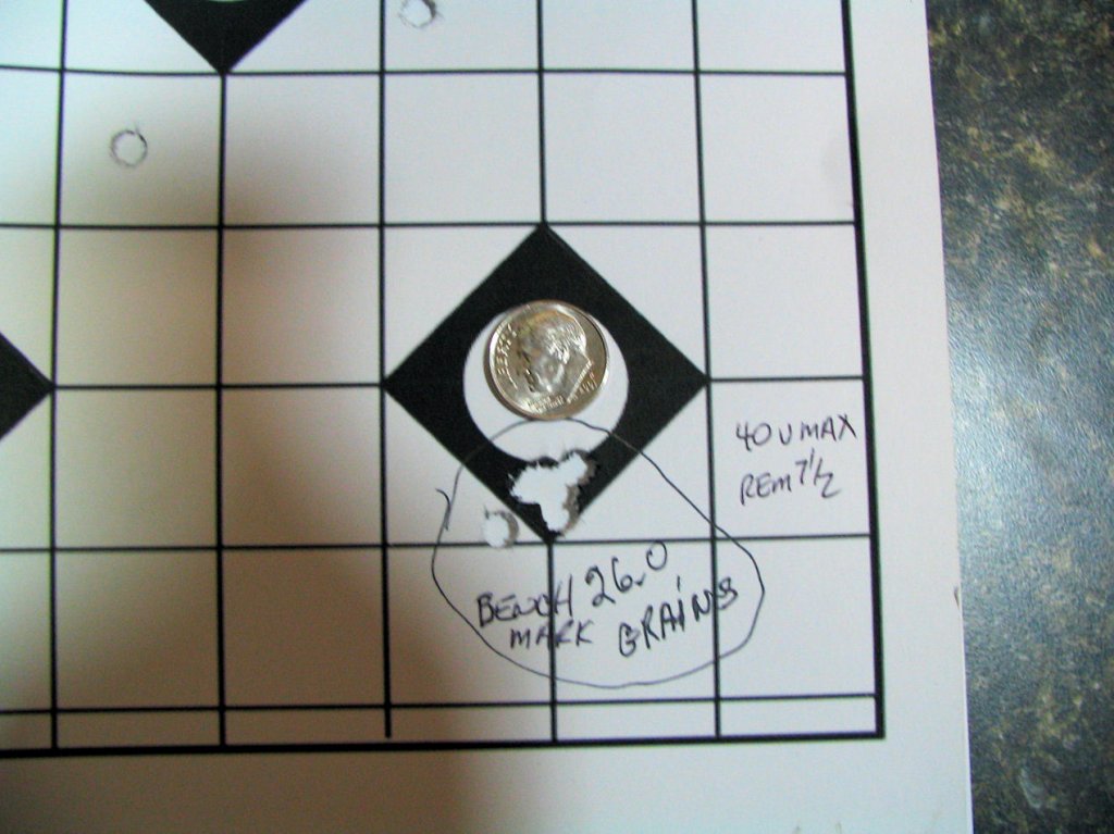

Here is the last group of 5 with 26.0 grains
Not too bad either, but another flier.
I think I can tighten these up some more (the fliers); not too bad for a 10X scope and my first loads tried ;D
Average for the 26.0 grains is 3575 fps (last five shots); for the 28.0 grains 3858 fps (last five shots). Just 2 fps slower than Noslers book value (3680 fps); I think I found my top load - will it be accurate enough?
BTW I was doing a lot of cleaning on the way to help break in the barrel. The last two groups (shown in order) were with 5 shots down the tube and no cleaning before or during the last 2 groups. The jury is still out if it will like a dirty barrel or a clean one; but it looks like a dirty barrel is going to prevail. I shot a total of 36 rounds today, just enough to get it some what zeroed and do some velocity/grouping testing.
