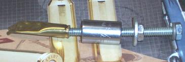

If you have a 1/4 - 28 tap in your tool box, take a look at this link and make your own:
http://www272.pair.com/stevewag/reloading/reloading2.html
Used a 1/4 - 20 tap on this version of the above.
You'll probably never need to use it again... ;)
Bill

Something similar to that used by OR-E-Gun Bill and it does work!  I know, I've had to use it to often lately.
http://www.surplusrifle.com/shooting/shellextractor/index.asp
