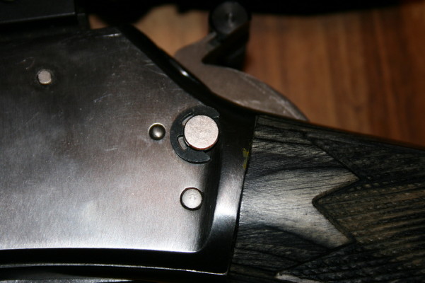

I am aware of the O-Ring set-up for the cross bolt safety & I think it is good, esp. if you want to take it off & back on fast. but for the humid area we hunt the o-ring can break down from the solvents/ois we use over time. I have also read of Paco Kelly's method & also a kit you can buy.
My brother came up with the idea to use an E-Clip. It's cheap, fast & works. Just slide on (stiff) the clip, it won't come off. If this has been thought of before, sorry.

  Looks like a good idea, not the most beautiful but it looks like it would work for sure. Anyone who watches Ted Nugent's "Spirit of the Wild" TV show saw Ted's brother mess up an Alaskan bear hunt with a borrowed Guide Gun. It was pretty amusing. The nice black bear came in and was working over the bait and CLICK,  off he goes. ;D  Does Ted ever hunt except baited animals from a blind?

And in keeping with the topic of this thread, the e-clip seems like a good solution for hunting in humid climates. Thanks for sharing the info, Nomosendero.

No need to put ugly o-rings or e-clips on your rifle. If you don't want to replace the safety with one of the available safety replacements then just remove the tang screw and buttstock. Make sure the factory safety is off and tighten the set screw all the way down that holds the spring and ball for the safety. It's on the left back side of the receiver. This will lock the safety down and have the same effect. It takes all but a minute to do.

Tell me this, what's the difference between using one of the E clips on a rifle and changing the cross bolt safety out?

My point is that if you use an e-clip, o-ring, tighten the set screw, or remove the crossbolt and replace with a plug it doesn't matter.  You are potentially accepting responsibility for any injury that happens as a result of accidental discharge.  Even if the person using the gun failed to follow safety procedures a lawyer will have a chance to take you on in court for defeating a safety device even if it is not the only one.  And a jury is likely to give your stuff to someone else out of ignorance as much as fairness.  I guess if I felt the need not to have the crossbolt I would sell the Marlin I have and get an older one pre that device.  As it is it causes me no trouble, so for me the fact that it is there is a non-issue.
