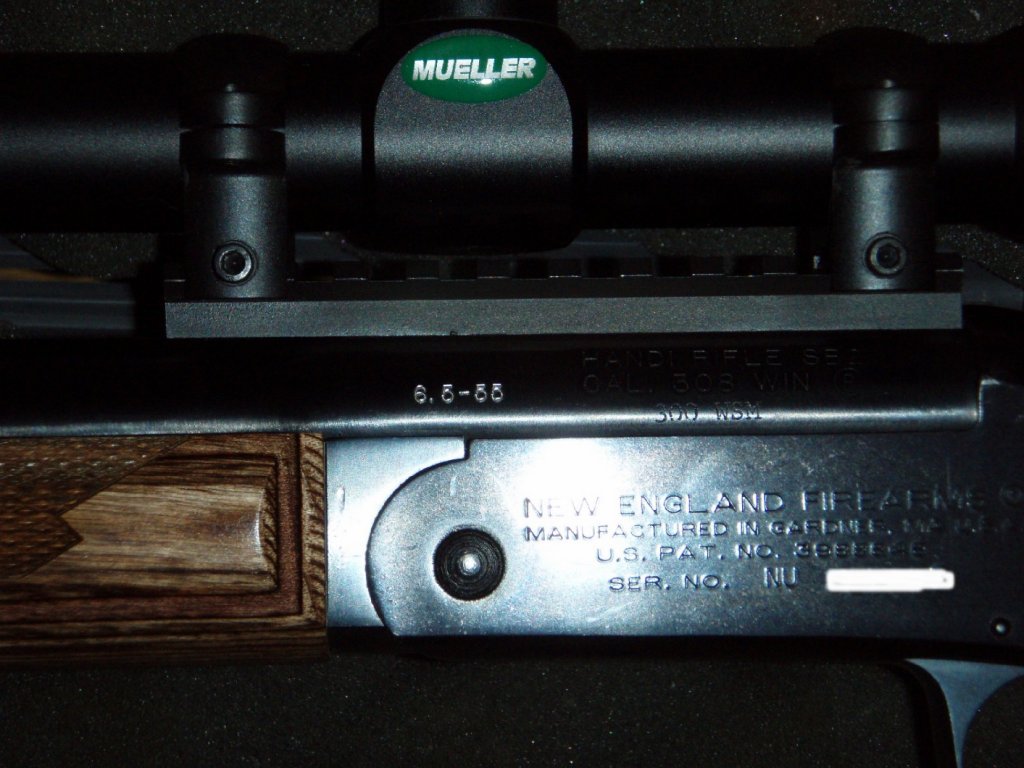

« Reply #7 on: January 10, 2009, 02:53:33 PM »
He did my 6.5x55 from the experimental 300WSM stub and a 6.5 Shilen match barrel, you can barely see the line where the two are mated about 1/8" back from the forend.

« Reply #8 on: January 10, 2009, 03:02:26 PM »
Thanks Tim.......You really are the man  ;D......That 6.5x55 is really one sweet round
