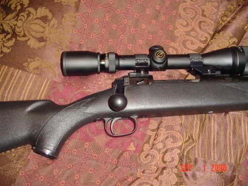

chlorinated brake cleaner if it is legal where you live
I used it for poor man's Gunscrubber.  I don't know about a Handi, but it will take the Fusion off a Savage.
As cwlongshot points out-  Duplicolor bedliner is cheap and nigh unto indestructible.  (as long as you like black)
Same Savage:
