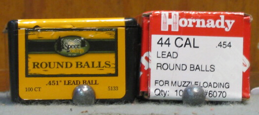

I've never tried the .454 dia. ball until just a few days ago.   I like them.   The .451's really don't seal as tight as I'd like them to in my Pietta 1860 .44's .   Some of the .451's didn't hardly shave off any lead when seated into the flutes.
Offline FourBee
  • Posts: 1770
Re: Ball size question
« Reply #13 on: January 02, 2009, 04:06:14 PM »
Today I shot 6 rounds of the SPEER .451" lead ball, 6 rounds of the Hornady .451", and 36 rounds of Hornady .454" lead ball.   Sure do like the .454" in my guns.    Can't hit nothin, but I like the tight fit.    At 100 yards I was able to get 4 rounds on the edges of the paper.   At 25 Yards I was able to do a little better, but not much.
